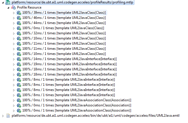

Re: [Acceleo] Performance Profiling [message #849478 is a reply to message #848901] Thu, 19 April 2012 03:27 Go to previous messageGo to next message
Hi Bart,
The Acceleo profiler aims at providing such statistics : http://wiki.eclipse.org/Acceleo/Profiler . 2.5 hours for a generation clearly is strange at best, especially considering the small size of your templates. Could you provide us with these templates and a sample model on which we could try and profile Acceleo itself to see if we can make things better?

Re: [Acceleo] Performance Profiling [message #876353 is a reply to message #876260] Thu, 24 May 2012 08:44 Go to previous messageGo to next message
Hi Ed,
i'm stuck. I upgraded to Acceleo 3.3.0RC1 as suggested. But the performance issues still remain. I setup a launch configuration with profiling support enabled. However, the profiling result looks fine (see attached screenshot). Nevertheless, it took 57s to complete the M2T transformation... At least i think the problem is not within the templates... But where could it be?
index.php/fa/9896/0/
Ah and btw: i tried Ed's suggestion and ran wireshark. But it didn't reveal anything suspicious...
[Updated on: Thu, 24 May 2012 08:56] by Moderator
Re: [Acceleo] Performance Profiling [message #876366 is a reply to message #876353] Thu, 24 May 2012 09:07 Go to previous messageGo to next message
Try increasing the number of open/closed projects, installed modeling
projects.
There a number of 'helpful' modeling applications that endeavour to
discover models and model elements so that you can access them easily.
These can scale very badly. Be suspicious of at least MWE, Xtext,
EMF-Index, Modisco, Acceleo.
If direct profiling doesn't help, try putting in a few
System.currentTime's to see which phase is going slow.
Try using a Java application rather than plugin launch.
If you're happy to use Acceleo 3.3.0RC1 then are you using Eclipse
4.2RC1? It seems like you're seeing something that we really want to fix.
Ed Willink

Thanks a lot for the hint Ed. I created a launch configuration for my toolset with only minimal requirements (Modisco & Acceleo are included though) and everything works fine now!! Now i'm trying to figure out, which plugin causes the explosion of the runtime complexity.
Re: [Acceleo] Performance Profiling [message #876446 is a reply to message #876385] Thu, 24 May 2012 11:52 Go to previous messageGo to next message
If you experience the same speed ration in a nested Eclipse, I suggest
instrumenting ResourceSetImpl.loadResource with some println's to see
what resources are loaded. The problem is almost certainly something
that loads everything.
Ed Willink

Re: [Acceleo] Performance Profiling [message #876511 is a reply to message #876446] Thu, 24 May 2012 14:41 Go to previous messageGo to next message
Ed,
thanks again for your valuable hints!! I tried your suggestion and found out that the EEF plugin causes the performance problems. Once it is deactivated, everything is fine.
I'm using Indigo SR2 Modeling Distribution. EEF Version 1.0.2.v20120216-1513
Kind regards,
Thomas
Re: [Acceleo] Performance Profiling [message #876531 is a reply to message #876511] Thu, 24 May 2012 15:36 Go to previous messageGo to next message
EEF is part of the Simultaneous Release so please raise a 'major' Bugzilla.
Ed Willink
On 24/05/2012 19:41, Thomas Buchmann wrote:
> Ed,
> Kind regards,
> Thomas
Re: [Acceleo] Performance Profiling [message #876555 is a reply to message #876531] Thu, 24 May 2012 16:34 Go to previous messageGo to next message
done: https://bugs.eclipse.org/bugs/show_bug.cgi?id=380589
Thomas
