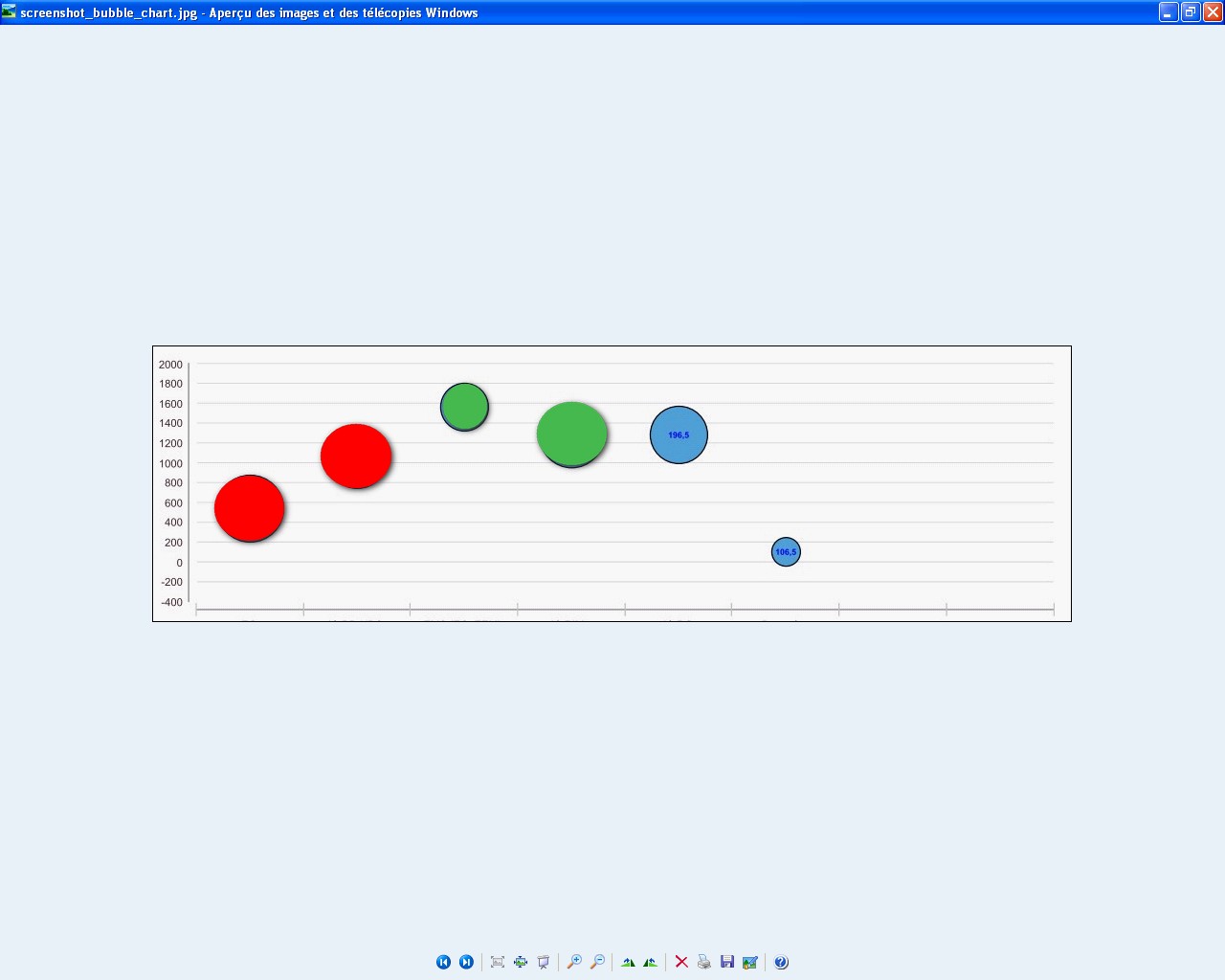

I am building a bubble chart and I wish to assign a color according to a value of my dataset which is not in the chart.
I suppose that I have to use code in order to realize it (Cf. attachment : screenshot)
On the screenshot the result that I wish : assign a special color to the area.
Any idea ?
Thank you.

I am attaching two examples. One that shows you how to set values in a
hidden table that can be referenced in chart script. The second shows
you to set the color of a bubble based on its size.
Jason

any way that I can have the bubbles color changed on my series1 ?
in my series1 i have a field that returns 1 to 4 which is number of bubbles on my chart, so I want to make 1 and 2 to yellow and 3 and 4 green ?
I have been using some script on my chart data already ?
if row[rownumber] < 2 yellow and if row[rownumber] > 3 green
thanks
