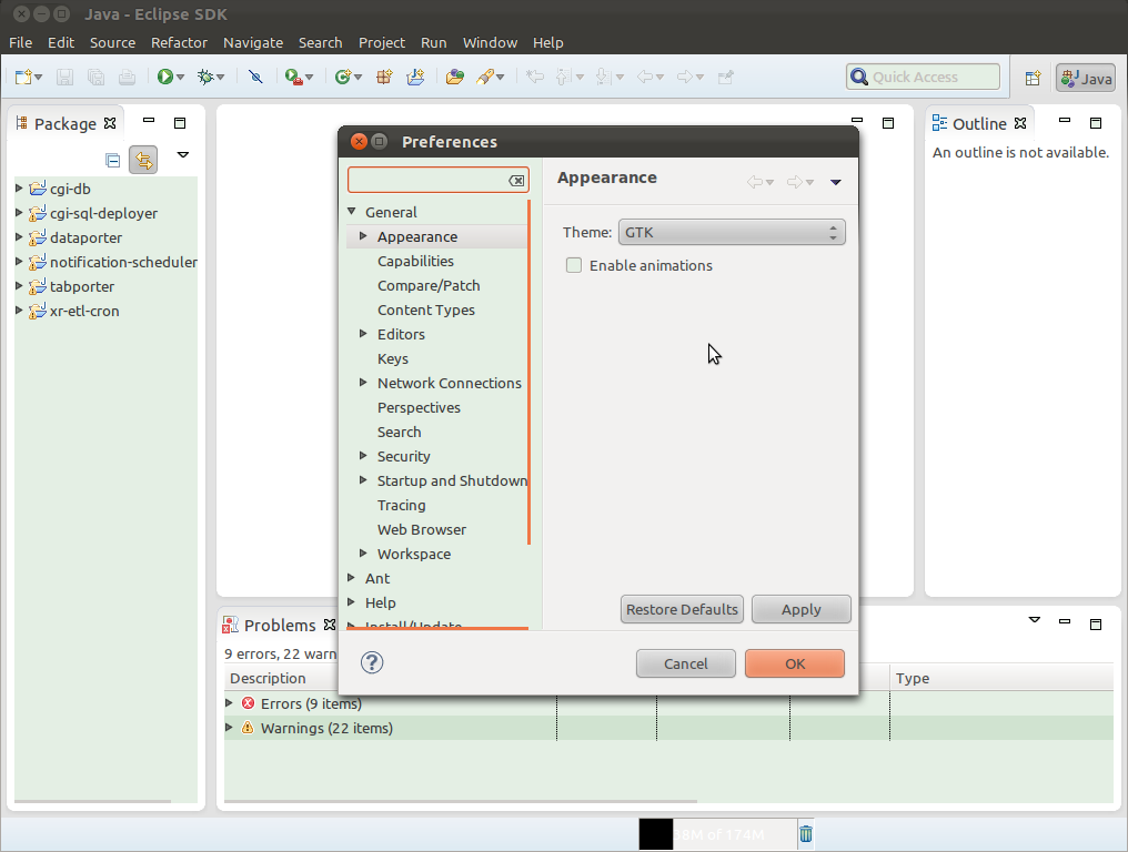

Re: Eclipse Juno themes [message #892541 is a reply to message #844978] Thu, 28 June 2012 10:54 Go to previous messageGo to next message
Yurx Cherio wrote on Sat, 14 April 2012 11:45
[..] The new Eclipse UI looks odd and inconsistent Confused with non-white system backgrounds. (see screen-shot). [..]
Seriously, how did you manage to get your Eclipse looking so 'smooth'? I've just installed Eclipse Juno (4.2 final) on my Ubuntu machine - and it looks quite awful, as you can see in the attached screenshot... *sigh*
(Note that grey-ish main toolbar - this is actually composed of a background image)
Best wishes,
Karsten

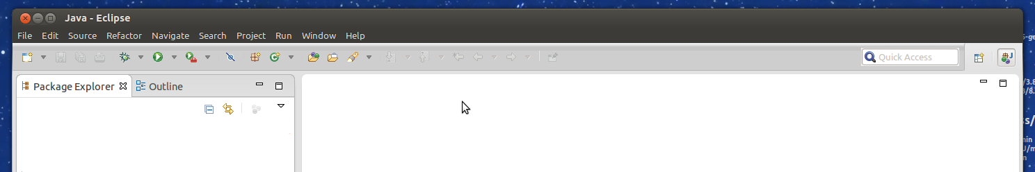

Re: Eclipse Juno themes [message #893203 is a reply to message #893200] Tue, 03 July 2012 03:58 Go to previous messageGo to next message
Archan Paul wrote on Tue, 03 July 2012 03:45
Edit following files to get desired results : [..]
Yes, I've done that already - the result is definitely a lot better, though still some weird issues remain (collapsed view area, see screenshot).

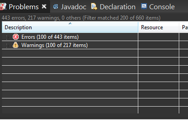

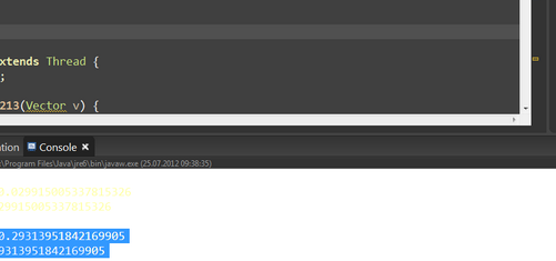

Re: Eclipse Juno themes [message #1020557 is a reply to message #844978] Mon, 18 March 2013 09:06 Go to previous message
I totally agree with all of you and this is definitely a bug.Currently eclipse is using system colors and eclipse theme colors meanwhile which causes a theme confliction(e.g. windows 7 default aero theme with dark eclipse juno theme).After installing dark theme(github.com/eclipse-color-theme/eclipse-ui-themes)for eclipse 4.2 sr2,there are still some weird issues:
- Console colors don't fit
- Scrollbar colors don't fit
- Table head row colors under "Problems" doesn't fit.
Screenshot as follows:

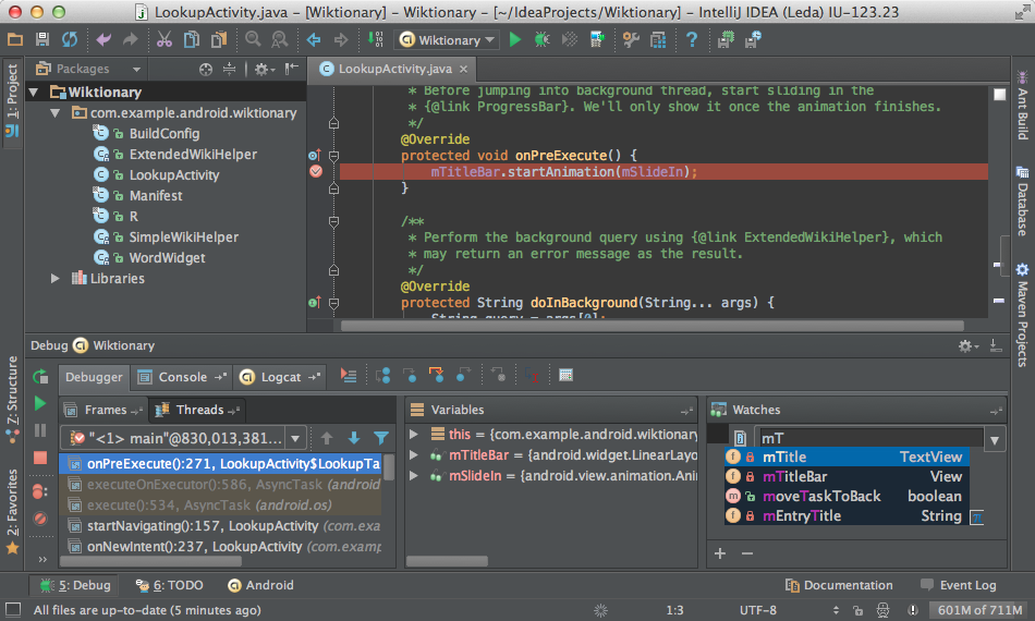

Nowadays, vs 2011(wpf based),netbeans 7.3.1(swing based) and intellij idea 12(swing based) have a full-featured high-quality and consistent dark theme except eclipse(swt based).
Attach iintellij idea's darcula theme for comparison.
index.php/fa/13904/0/
