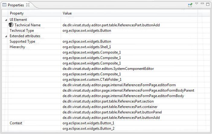

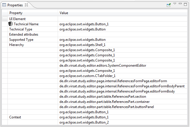

The following picture is showing the technical names for one of the buttons from the first tab in the editor. It was possible to check its enabled state succesfully.
index.php/fa/7884/0/

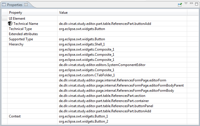

The following picture is showing the technical names for one of the buttons from the second tab in the editor. In this case the component could not be found.
index.php/fa/7883/0/

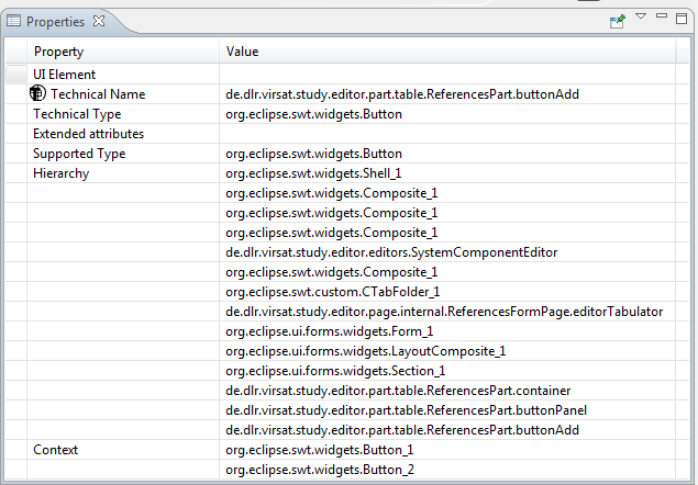

3. No, the hierarchy is not regenerated. I started to put some extra naming into the hierarchy just to be sure, and for fixing the names. At the stage where the component could not be found the hierarchy looks like this:
index.php/fa/7889/0/
After that I cut the link in the OM-Tool and used the Tool to find the button again. The hierarchy seems identical:
index.php/fa/7890/0/

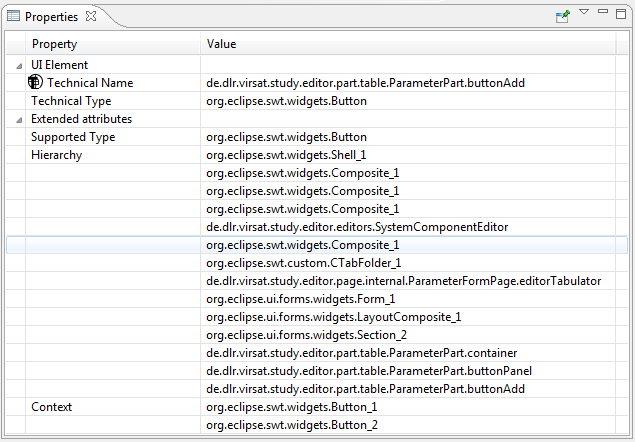

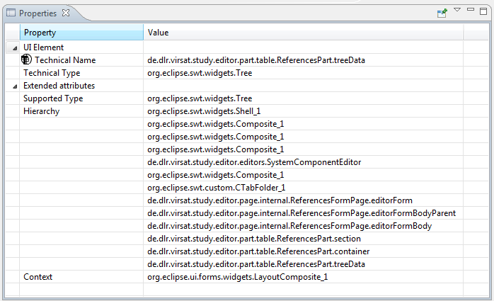

If I am trying to check the enabled state of the table it works fine. No matter if the table is within or out of sight of the scrolling editor. The buttons are placed in an extra container right below the table, maybe its the extra bit in the hierarchy that is disturbing.
Attached is the hierarchy to the references table which can be found. the buttons right below cannot be detected.
index.php/fa/7893/0/

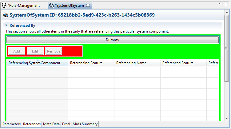

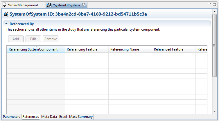

thanks for your support so far. Still nothing realy helped. The click into component did not make a difference. I actually tried to move the buttons on top of the table, so that they are clearly within sight (I attached a picture). But again, the component could not be found. The table below is clearly identified. Your second idea of trying to click them (i changed them to be enabled) did not help as well.
index.php/fa/7936/0/
I will recheck our implementation, maybe we messed something up with the composite that is grouping the buttons. Still i dont see why it is working well with the first (Parameters)tab, but not the others. It doesn't look to promising at the moment Sad

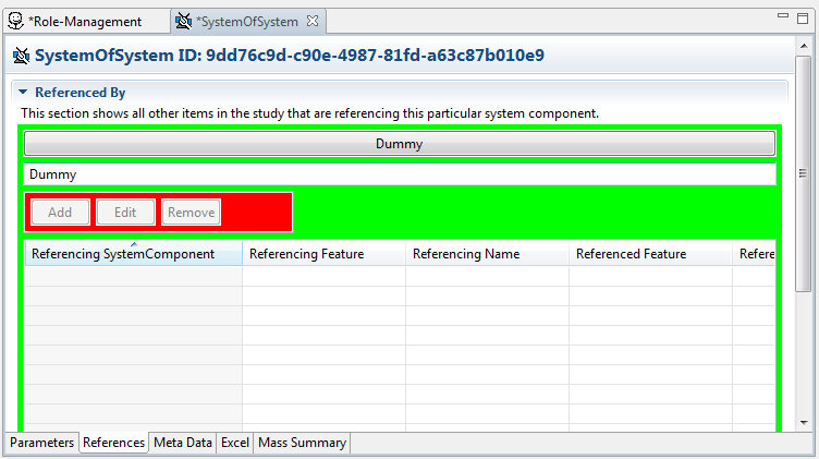

Hey Alex,
I tried to introduce a dummy button, it is placed into the same composite as the table. As I mentioned, the table can be found and this has not changed. Nevertheless the dummy button cannot be found like the other buttons.
index.php/fa/7945/0/
This raised my attention, hence I added another dummy textfield as well. The dummy textfield is identified same as the table. Nevertheless none of the buttons can be found. To me this indicates some problem in jubula not beeing able to find the buttons correctly after a tab change. What do you think?
index.php/fa/7946/0/

Found a WORKAROUND Very Happy !!! As mentioned before the test used to work before we introduced the technicla names. Nevertheless we needed the technical names due to some problems with our generic tables. Accordingly i went half way back and removed the technical names from all buttons but left them with tables and the composites in particular. Even though I don't realy fency this approach Confused still it is a reasonable fix for us. Apparently the hierarchy given by the composites helps to clearly identify the buttons even without technical names.
index.php/fa/7991/0/
Hope this gives some help to others encountering similar problems.
