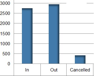

I want to create this report in BIRT.
index.php/fa/7813/0/
My SQL expression in Data Set is:
SELECT DISTINCT
(select count(*) FROM STATUSTABLE where date (createdate)>'2012-04-01') AS IN,
(select count(*) FROM STATUSTABLE where date (createdate)<'2012-04-01') AS OUT ,
(select count(*) FROM STATUSTABLE where status='CANCELED') AS CANCELED
FROM STATUSTABLE
Result of SQL is on example:
IN|OUT|CANCELED
210|30|4
How to set bar chart to create this kind of report if this is possible?
How to achieve that y-axis will show me this values and on X axis (probbably the bigest problem) to have this Labels IN , OUT , CANCELED separately on the sam bar chart?
Thanks for help
  • Attachment: count.jpg
    (Size: 16.76KB, Downloaded 3584 times)
[Updated on: Sun, 08 April 2012 14:22] by Moderator
Re: How to display multiple COUNT results in bar chart? [message #840083 is a reply to message #839430] Mon, 09 April 2012 12:34 Go to previous messageGo to next message
Generally the chart engine expects one or more rows per category. For
the chart you want the table would look like
Cat Val
in 210
out 30
canceled 4
You can add values in script but it makes it a bit more complicated.
Look at the script on the attached example.
Jason

Re: How to display multiple COUNT results in bar chart? [message #840845 is a reply to message #840475] Tue, 10 April 2012 11:23 Go to previous messageGo to next message
Probably the easiest way to make this work in your example is to drag
your data set to the report canvas. This will create a table. Select
the detail row and choose an oncreate script and enter something like this.
var inval = this.getRowData().getColumnValue("in");
var outval = this.getRowData().getColumnValue("out");
var canval = this.getRowData().getColumnValue("cancelled");
reportContext.setPersistentGlobalVariable("In", inval);
reportContext.setPersistentGlobalVariable("Out", outval);
reportContext.setPersistentGlobalVariable("Can", canval);
Then choose the visibility property for the table and hide the table.
Note that your code will still execute.
Next create a simple bar chart with a 1 in the value expression and
"Test" in the category value. Then put the following script on the chart.
importPackage( Packages.java.util );
importPackage( Packages.org.eclipse.birt.chart.model.type.impl );
function afterDataSetFilled(series, dataSet, icsc)
if( series.getClass() == BarSeriesImpl ){
var inv =
parseInt(icsc.getExternalContext().getScriptable().getPersistentGlobalVariable("In"));
var outv =
parseInt(icsc.getExternalContext().getScriptable().getPersistentGlobalVariable("Out"));
var canv =
parseInt(icsc.getExternalContext().getScriptable().getPersistentGlobalVariable("Can"));
var narray1 = new ArrayList( );
narray1.add(inv);
narray1.add(outv);
narray1.add(canv);
dataSet.setValues(narray1);
}else{
var catArray = new ArrayList();
catArray.add("In");
catArray.add("Out");
catArray.add("Cancelled");
dataSet.setValues(catArray);
See attached example.
Jason

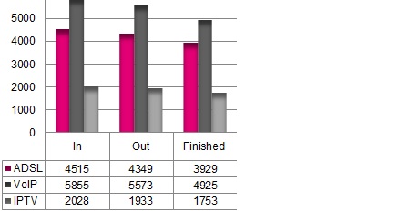

Just one more question if you know:
Is it possible to I create also and this graphic or I must do it 3 times separately for each service (ADSL,VOIP,IPTV) separately.
index.php/fa/9916/0/
I can get one table with grouped 3 rows and 4 columns.
I tried to create bar chart with your suggestion "Test" for x and 1 for y values and I did it three times because I must create 3 Series (New Series ) on Value Y Series.
But new series will take only different column not and different value for row (ADSL,VOIP,IPTV).
Is it possible to I create this report?
If not then I will create three separate charts.
THANK YOU ONCE AGAIN!!!
  • Attachment: bar.jpg
    (Size: 23.70KB, Downloaded 3280 times)
