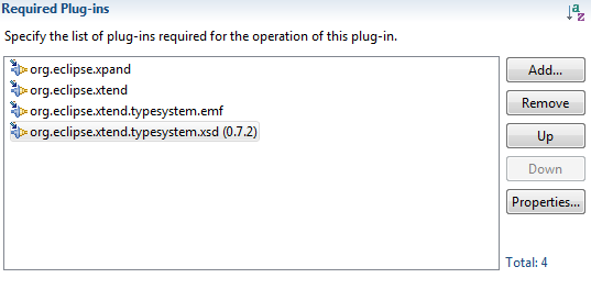

open the manifest.mf file and add it there in the dependencies tab under required plug-ins
Re: Migration OAW4 to OAW5 [message #837135 is a reply to message #837127] Thu, 05 April 2012 06:02 Go to previous messageGo to next message
Okay i had the plug in XSD but now there another errors.

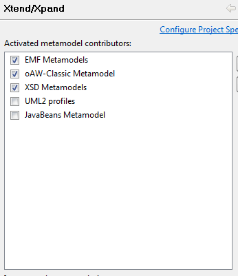

Re: Migration OAW4 to OAW5 [message #837138 is a reply to message #837135] Thu, 05 April 2012 06:05 Go to previous messageGo to next message
I forgot this. (Image include)
