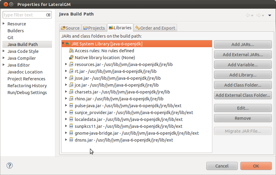

I have a jar, /LateralGM/lgm16b4.jar which is a build of the project, and it does seem to be grabbing the class files from in there.
However, I didn't specify to include this jar in the build path anywhere. You can see in the image/file that I provide with this post.
So I guess we either need to inform it that the jar's source is /LateralGM, or else tell it to stop using the Jar. I'm not sure how to do this.
