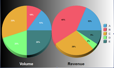

on Birt 3.7.2 RCP & Web viewer, in this very simple report sample 2 pie charts series are defined. Both use a drillthrough interactivity action to the sample target report.
index.php/fa/7596/0/
The first chart serie is using a multivalue parameter in the link drill to the target, and the second a singlevalue, with very simple expressions such:
params["multivalue"].value
params["singlevalue"].value
At runtime none chart is displayed and i get this stack error:
Chart (id = 10):
- The trigger data is invalid or its type is unknown. (Element ID:10)
exception.unknown.trigger.datatype ( 1 time(s) )

I noticed:
- If both charts series use the single value parameter in the drill action, then it works.
- It only happens within a chart, the same scenario works with a drillthrough defined on a crosstable or a table, even with multivalues.
Is it a known issue or should i log a bugzilla entry for this? May be i misunderstood something about the way to manage a multi-value parameter in a chart interactivity?
Thanks!
