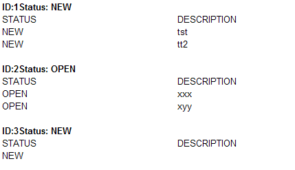

I guess you only need to separate tables visually, right? I have attached example where grouping is used (birt 2.6.1).
--- edit
For complete reference I have added similar example using filters on slave table.
Tomas
