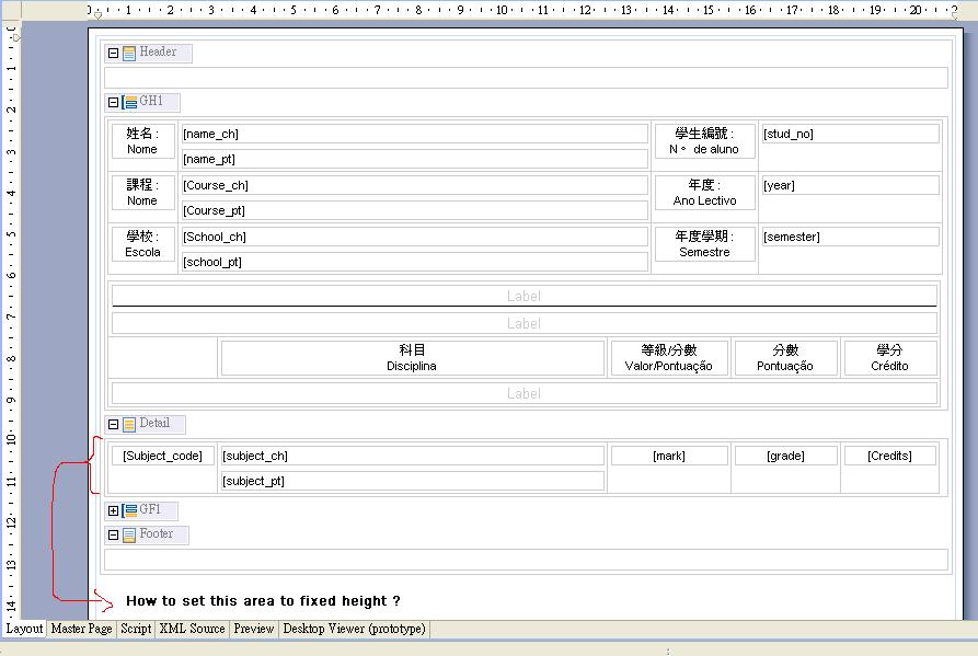

I use (list item) to make a report.
I have some question can i modify the "detail" area height ? Is it possible to fixed this section height ? thank you

What version of BIRT are you using? If you set the report to fixed
layout and then click on the detail row you can set the height in the
General properties for the row.
Jason
