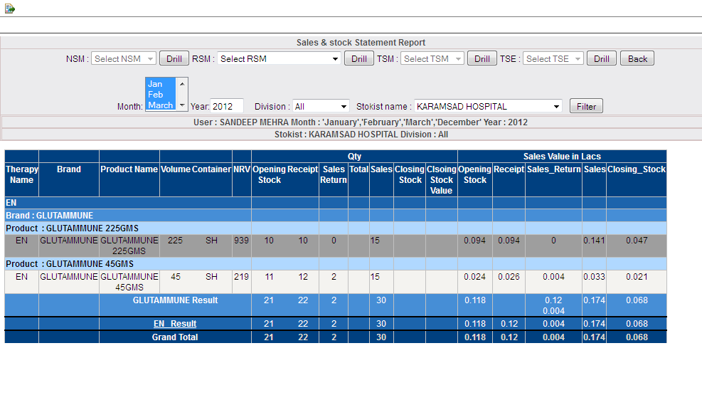

whenever i am trying export my tabular report to excel its giving error in
excel sheet (attached below).
Also graphical charts are not reflecting in excel sheet.
I tried tribix excel emitter but it is not keeping source report format in output excel sheet.
please suggest solution for this . I am using birt runtime 3.7 and apache tomcat server for deployment.
i am also attaching my report and its screen shot. i am calling report using Birt viewer.
