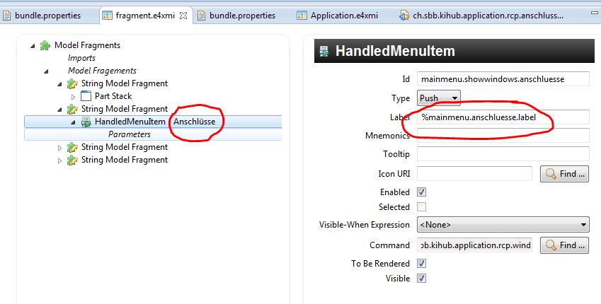

We have an E4 M4 application with a plugin with a OSGI-INF/l10n/bundle.properties.
This is working.
Then we defined a plugin dependent from this one with a model fragment inside.
In this one we also have a OSGI-INF/l10n/bundle.properties.
But all the labels defined inside that file are not translated in the application.
The funny thing is, when we open the fragment in the model editor, the label gets correctly processed there (see screenshot)
Looks like a bug, is it?

Re: Localization in fragment not working...bug? [message #820632 is a reply to message #820622] Wed, 14 March 2012 07:16 Go to previous messageGo to next message
Hi Tom
thanks for the answer, I did what you suggested with the live editor.
The Menu element with ID "mainmenu.showwindows" is in the father plugin (application.rcp) and has the right contribution URI
The HandledMenuItem element with the id "mainmenu.showwindows.anschluesse" is in the fragment, and I see no contribution URI there:
<children xsi:type="menu:Menu" xmi:id="_HP3NAGOuEeGQTYWEOT6MuA" elementId="mainmenu.showwindows" contributorURI="platform:/plugin/ch.sbb.kihub.application.rcp" label="%mainmenu.showwindows.label">
<children xsi:type="menu:HandledMenuItem" xmi:id="_VG258Gj8EeGpkeMRc3nrfg" elementId="mainmenu.showwindows.anschluesse" label="%mainmenu.anschluesse.label" tooltip="" command="_FdgKMGkiEeGqltlojNHlng"/>
</children>
