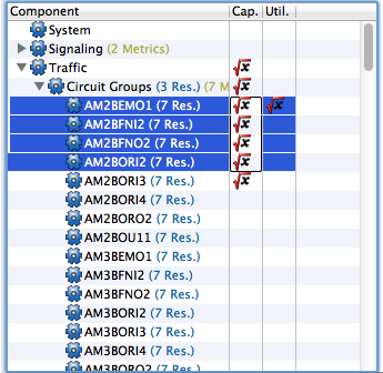

Hi There,
I have created a specialized version of the SWTFocusCellManager, named SWTFocusBlockManager
It maintains a drag state, and updates the block of cells which have focus. For this I also needed a specialized implementation of the FocusBlockHighlighter. This updates the column focus selection.
While draggin, a command can be prepared. When Mouse.UP the command is executed.
See a screenshot attached.
- It now works with SWT.MULTI selection on.
- The copy command is embedded in the SWTFocusBlockManager, while it shouldn't be part of it.
I would like to share this with JFace, so perhaps it could be useful to others, and I would really like some experienced JFace people to review the code. What would be the best way to go about? A bug with the code attached as a patch?
TIA, Christophe Bouhier

a) file a bugzilla and include there
b) Maybe create a small snippet to see it in action which we are going
to reference from http://wiki.eclipse.org/JFaceSnippets
Simply CC me on the bug - the JFace(-Viewers) area is currently lacking
some TLC. We are past API freeze for Juno but if the API is generic
enough we can maybe integrate it into JFace post Juno.
Tom

Here is a bug with a working snippet. (I removed the part where a command is created, as it should be external to JFace really).
https://bugs.eclipse.org/bugs/show_bug.cgi?id=374051
