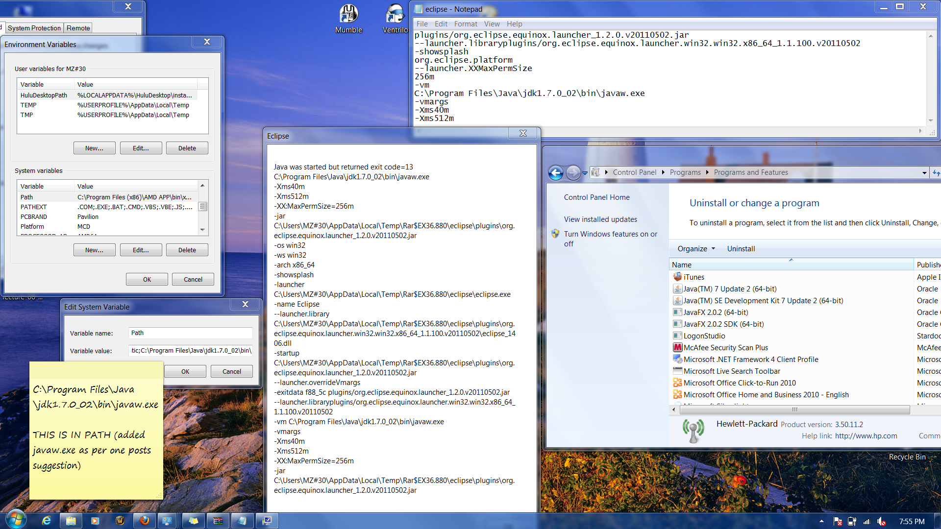

I have tried looking this issue on the site and trying to fix it with the given advices but just couldn't make it work for myself so I have decide to ask for help this way.
I know there have been multiple issue with this and posts have been made but here we go. Again, I just want to say that I have tried searching this and fixing it with already given advices but could not make it work.
The jdk works fine but the Eclipse is causing the issue here for me. Here are the screenshots of the error message, the path that I have set up for jdk, the list of jdk installed on my pc, and the .ini file from the eclipse (this one i have tried adjusting as I saw in one of the posts here on the forum). Any help is much appreciated as I really need to get this thing to work.
This is all for .64 bit version btw.

Looks like your Eclipse is 32bit but the JVM is 64 bit.
Re: Not able to run Eclipse [message #817343 is a reply to message #816956] Fri, 09 March 2012 19:26 Go to previous message
I have tried several versions, and variations... i have tried running 64 jdk with 32 and 64 eclipse and it still the same issue
