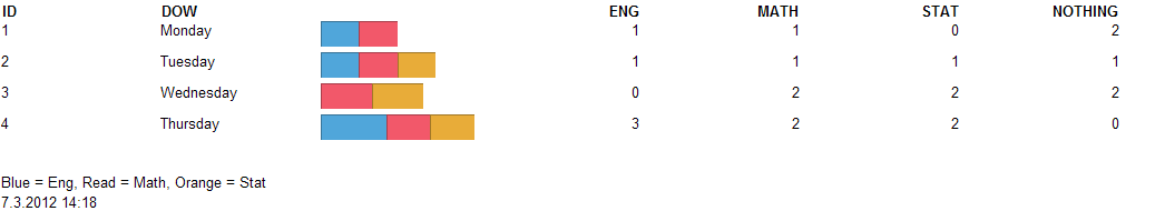

i need to creat 1 cell with deferent coloring percentage.
the coloring of the cell should be dependent between the rows
for example i have some school cariculum.
each day has deferent amount of learning hours.
in each day i have deferent amount of hours for english and for math.
on sunday we had 6 hours 3 of them english 3 math
on monday we had 4 hours 2 of them english 2 math
so i want my out put report to have 2 lines, one for sunday one for monday.
and the overtime cell should be colured on the first row: 50% green(english),50 red(math).the second row over time cell should be 30% green(english),30%red(math), 30% no colur(should be aligned with the first row with 6 hour)

please check atached report (birt 2.6.1). I am not completely sure I understand your needs, however it can give you an idea. Also screenshot of report is attached.
Report is using classicmodels db.
Tomas
