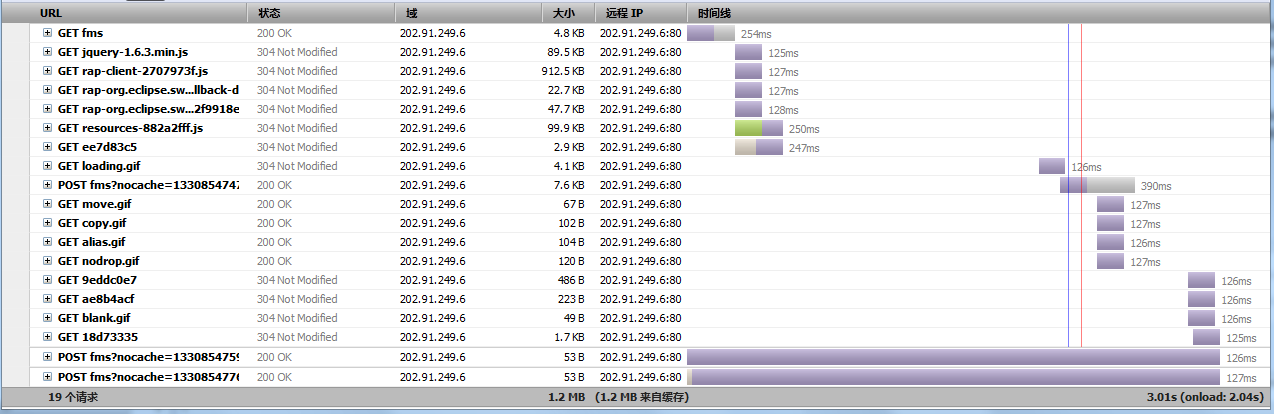

Hi all,
I test my app and give a firefox download size below:
index.php/fa/7394/0/
the download is 1.2mb, so large! but how to reduce the downloads?
David

Am 04.03.2012 10:59, schrieb Song David:
> Hi all,
I dont think 1.2mb is not that much, many regular websites have 0.5 -
1.5mb. While there are some things you could do to redouce size, it
would only get you a few KB. Anyway, all the images and much of the JS
files are chached by the browser, so this is only downloaded on the
first request. After that its only a few KB starting an simple RAP
application.
Greetings,
Tim
