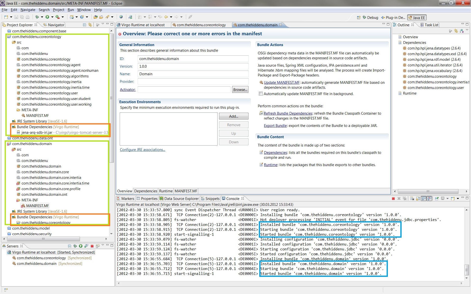

Thanks Leo! I also tried with M02 version of server and snapshot Virgo tooling now. I checked the Target Runtimes and Bundle Dependencies... No success. Sad
Take a look at the attached screenshot: I have two bundles, both require dependencies from a Jena library, which I put in the repository. Both bundles can be deployed and started successfully. Still, for one of the two bundles, the wizard tells me that the Import-Packages cannot be resolved.
(I created a Jena-Library-JAR using bndtools, all required dependencies were taken from the SpringSource Bundle Repository. I used a fresh installation of Eclipse with the latest snapshot of Virgo Tooling, and in the workspace there are only one server and only one server runtime environment.)
Interestingly, the very same bundles work perfectly fine with an old installation of SpringSource Tool Suite 2.8.1, Virgo 3.0.1, and Virgo tooling 1.0.0.201110312003-SNAPSHOT. I just tried once again, starting from a fresh workspace in that installation. Everything is fine there. (EDIT: Web Application Bundles seem to make trouble already with Virgo 3.0.2 and this version of tooling.)
Afterwards, I started the other installation with 1.0.0.201203202115-SNAPSHOT, created a new 3.5.0.M03 server (same files in repository/usr), and imported all the bundles form the first workspace. I can clean, build, and deploy my bundles - no errors occur so far. Also after restarting Eclipse.
However: Once I open the wizard for one of my manifests and add a whitespace somewhere, and save the file: the errors are back: "Import-Package: ... cannot be resolved" and bundle dependencies are empty again. (There are no errors in the workspace .metadata/.log)
Rolling Eyes
Should I file a bug?
All the best,
Martin

Re: Empty bundle dependecies after upgrading VTS to 3.5.0.M2 [message #832902 is a reply to message #832767] Fri, 30 March 2012 14:43 Go to previous messageGo to next message
That's bizarre. So upon editing the manifest and saving it, the project loses its Bundle Dependencies state and all Import-Package headers are unresolved? If you clean the project after one of these edits, does it rebuild properly or does it continue to report the same errors?
Yes, please file a bug. It would be nice to have a screencap with the specific errors that are reported on the MANIFEST.MF tab or the Markers view if possible.
