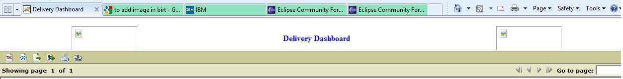

Re: Customising BIRT Sample Viewer [message #878549 is a reply to message #814647] Tue, 29 May 2012 10:08 Go to previous messageGo to next message
Hi Jason
I made the changes in the file-->
webcontent\birt\pages\layout\FramesetFragment.jsp
But font-size of title is very small. I tried to increase it but its not
being displayed on the web page.I tried to insert images in the heder but its
not working. I gave complete image path still the images are
not shown in the web page header. Need help.
Here is the code I used.<!-- Header section --> (as you said line 140)
<TABLE ID='layout' CELLSPACING='0' CELLPADDING='0' STYLE='width:100%;height:100%'>
if( attributeBean.isShowTitle( ) )
<TR>
<TD COLSPAN='2'>
<TABLE BORDER=0 CELLSPACING="0" CELLPADDING="1px" WIDTH="100%" align="center">
<TR align="center">
<TD > <img src="D:\new\Tomcat 6.0\webapps\birt\webcontent\birt\images\LOGO1.jpg" style="height: 49px; width: 132px; "></TD>
<TD style="color:blue; font-size: 100"><B>Delivery Dashboard</B></TD>
<TD><img src="D:\new\Tomcat 6.0\webapps\birt\webcontent\birt\images\imagesC.jpg" style="height: 49px; width: 132px; "></TD>
</TR></TABLE></TD></TR>
Here is the snapshot of the report (viewed on tomcat server)
index.php/fa/9941/0/
Waiting for your reply eagerly.
Thanks and Regards
swapnil

Re: Customising BIRT Sample Viewer [message #878631 is a reply to message #878569] Tue, 29 May 2012 11:50 Go to previous messageGo to next message
Can you try putting the images in the following folder
and then reference them like:
<TR align="center">
<TD > <img src="birt/images/LOGO1.jpg" style="height: 49px; width:
132px; "></TD>
<TD><img src="birt/images/imagesC.jpg" style="height: 49px; width:
132px; "></TD>
Jason

Re: Customising BIRT Sample Viewer [message #878863 is a reply to message #878631] Wed, 30 May 2012 00:56 Go to previous messageGo to next message
Hi Jason,
Hay.... Thanks. It worked.
But the problem of the font size continues. No matter what font size I use in
code the web page displays the same tiny heading as "Delivery Dashboard".
How can I increase the font size?
<TD> <img src="birt\images\LOGO1.jpg" style="height: 49px; width: 132px; "></TD>
<TD> <img src="birt\images\imagesC.jpg" style="height: 49px; width: 132px; "></TD>
Thanks and Regards
Swapnil
Re: Customising BIRT Sample Viewer [message #879160 is a reply to message #878863] Wed, 30 May 2012 12:20 Go to previous message
TryL
<TD style="color:blue; font-size: 20pt"><b>Delivery Dashboard</b></TD>
Jason
