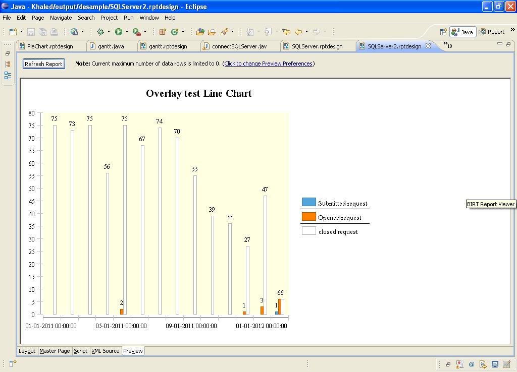

I've created a report which generates a chart using BIRT Designer 3.7.1 and now I want to create the same report with the design engine

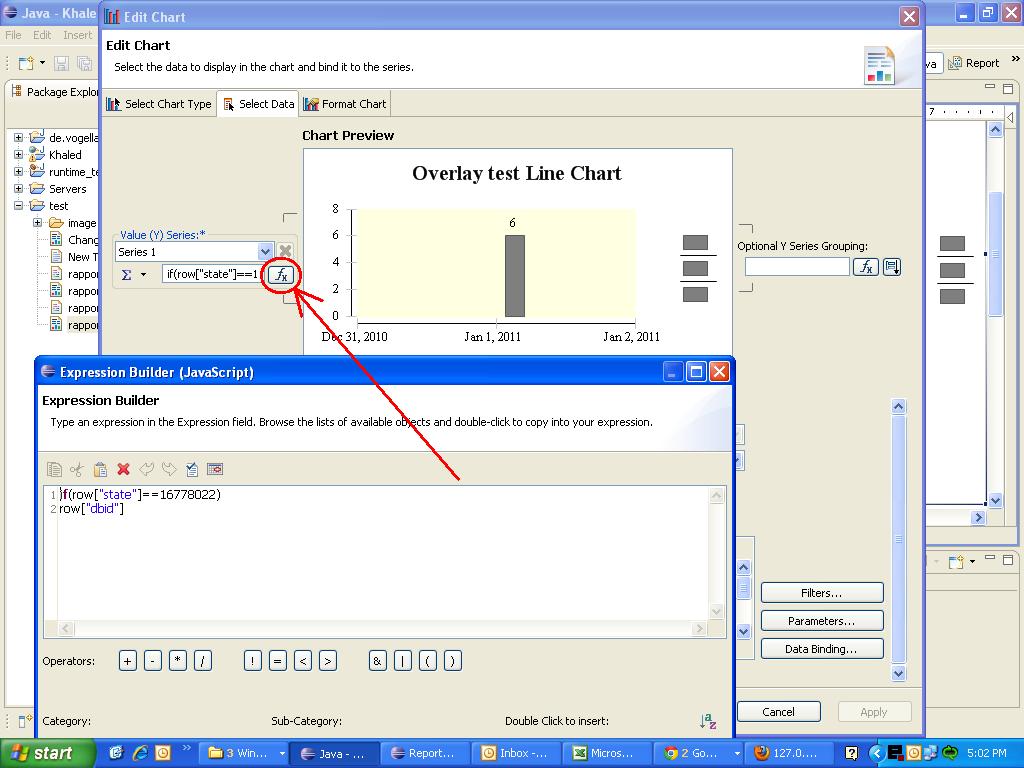

My chart contains 3 Bar series each one uses its JavaScript code (see the attached picture for more details)
My question is how can I include a JavaScript code into my Design Engine???

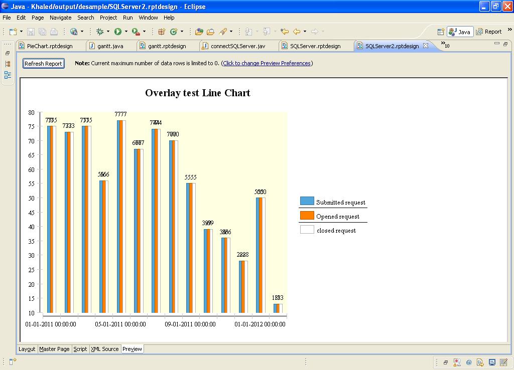

Re: Setting data using JavaScript on BIRT DE [message #811397 is a reply to message #810927] Fri, 02 March 2012 04:47 Go to previous messageGo to next message
thanks Jason for your answer but can you explain more because I'm still having problems with this script (what's \"my product\" and where exactly I have to put my script)
I will explain what I want to do exactly:
I have many types of requests and I want to create a bar series for each one (submitted / opened / closed)
so I used this query as a data set: select dbid,submit_date,state from tab1
and I created the chart using the code in the first message and now I have to add scripts for each series
the first script is : if(row["state"]==16778022) {row["dbid"]}
the second one is: if(row["state"]==16778023) {row["dbid"]}
the last one is : if(row["state"]==16778024) {row["dbid"]}
I attached two files the first is the chart before adding scripts and the second after adding scripts
I generated the second one using BIRT designer and now I want to do that using the Design Engine
So what should I put exactly in QueryImpl.create()????

Re: Setting data using JavaScript on BIRT DE [message #811401 is a reply to message #811397] Fri, 02 March 2012 04:54 Go to previous messageGo to next message
Sorry about the pictures' order:
the file "BirtDE2": chart after adding scripts
the file "BirtDE1": chart before adding scripts
I want to add that I tried QueryImpl.create("if(row[\"state\"]==16778022) {row[\"dbid\"]}");
but I got a bad result (the same as BirtDE1.JPG)
I tried other ones like QueryImpl.create("row[\"dbid\"] + if(row[\"state\"]==16778022) {row[\"dbid\"]}"); but I've got syntax errors in the viewer

probably will not use this approach). Bear in mind that all series have
to have the same number of data points. So if you are filtering in an
expression there still has to be the same number of data points. The
example was done in 2.6.1, remove the setting of birt home if you are
using 3.7 or greater:
Jason
