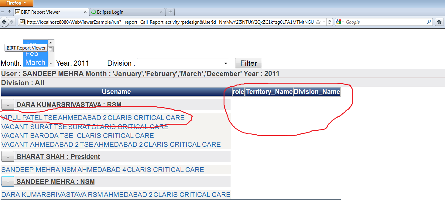

But in my report i am facing row formatting problem . when we click on button to unhide/show the detail rows ,all data is get placed in first column only .
Please see attached image. How ever your collapset.rptdesign report is working fine without any formatting issue.Have you used any special formatting for detail rows?
Rahul
Re: birt report java script problem in chrome and firefox [message #816509 is a reply to message #815979] Thu, 08 March 2012 18:37 Go to previous messageGo to next message
Try setting your display to '' instead of 'block'

icon14.gif  Re: birt report java script problem in chrome and firefox [message #816824 is a reply to message #816509] Fri, 09 March 2012 04:56 Go to previous messageGo to next message
Thanks Buddy , Its working fine now
Rahul Smile
