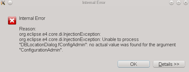

I first posted this question in the equinox forum, but now I suspect it may be a bug in e4.
I get the following exception
org.eclipse.e4.core.di.InjectionException: Unable to process "WorkbenchStatusReporter.shellProvider": no actual value was found for the argument "IShellProvider".
The problem can be traced down to the following piece of code
@Inject
private ConfigurationAdmin fConfigAdmin;
that is located in a dialog DBLocationDialog, which is opened through a menu-handler, as given here
public class DBLocationHandler {
	@Execute
	public void execute(IEclipseContext context) {
		DBLocationDialog dialog = ContextInjectionFactory.make(DBLocationDialog.class, context);
		dialog.open();
As written in my post cited above, the problem only occurs, when the configuration admin bundle is started with default startlevel and default auto-start. When that bundle is started with auto-start true, the exception is not thrown, i.e. the injection in the dialog succeeds.
Now I get the same exception with a test component of mine. The code causing the exception is again
@Inject
private ITest fTest;
The interface is implemented through a lazily activating component. At first, the service ITest is not used, as shown in the osgi console
{de.trm.app.ITest}={component.name=de.trm.app.Component, component.id=9, service.id=43}
"Registered by bundle:" de.trm.app_1.0.0.qualifier [53]
"No bundles using service."
The component is not activated yet. When the same dialog is called through the same menu-handler, the same exception occurs, but the component is activated right before:
osgi> $$$ COMPONENT STARTING
The text "$$$ COMPONENT STARTING" is written to System.out in the Activate-method of the test component. Now the osgi console says
  "Bundles using service"
    org.eclipse.e4.ui.workbench_0.10.1.v20120126-1604 [48]
Since e4 is now using this component, why fails the injection of ITest? To me it looks as if it is a bug in e4.

Yes, but the bug you cited is not the problem. I tried the same with the platform as target, which is 4.2-I20120209. I got another exception showing explicitly, that the injection failed, see the attached screenshot. So the exception only provides better information now, but we learned nothing we didn't know before.
I will try to create a minimal example to reproduce the error and file a bug.
index.php/fa/7192/0/

Sorry, I have to correct myself. One should think first and write later... The Configuration Admin does not seem to be part of the platform, so this injection must clearly fail.
However, once I make the injection of the Config Admin @Optional, no further problem occurs, which means, the injection of my test component works. Hence, the bug you cited seems to have indeed been the cause of my problem.
