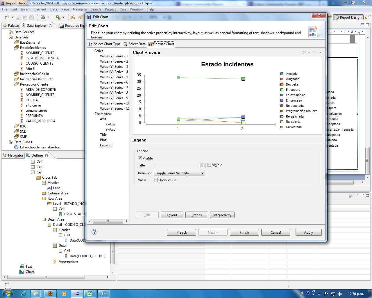

Good morning
Thanks for your time, I have a problem with the legend of a report that is type lines and is showing a lot of category but I want the legend show only items that had values ​​greater than 1 that is not listed in the chart not appear in legend as the 20 values ​​is very great legend and almost never have all greater than 0
thanks

You can do this with some chart scripting. Look at the attached example
that checks all the values of every runtime series to see if all the
values are less than 20. If all the values are below 20, the legend
item is removed.
Jason

Is exactly what I need, great answer!!!
thanks a lot Jason
