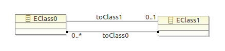

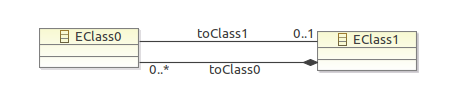

Let's consider 2 use cases :
1)
index.php/fa/7130/0/
2)
index.php/fa/7131/0/
In both cases, this is a bidirectional relation, with opposite correctly set. Both relations are set unordered.
But in the use case 1, a joined table is generated. In the use case 2, the mapped-by property is correctly set.
My question is : why is a joined table used in the use case 1 ? Because I don't see a valid modeling reason.
Thanks in advance !

Re: [Texo]Don't understand JPA generation strategy on bidir relation 0..1 to 0..* [message #797630 is a reply to message #797519] Mon, 13 February 2012 13:19 Go to previous messageGo to next message
Hi Benoit,
There are properties you can set in the annotation model on epackage level which control if join tables are created for
associations (contained or non-contained). As a default for containment associations no-join table is used and for
non-containment associations a join table is used.
Does this answer your question?

Re: [Texo]Don't understand JPA generation strategy on bidir relation 0..1 to 0..* [message #798080 is a reply to message #797630] Tue, 14 February 2012 03:17 Go to previous messageGo to next message
Hi Martin,
This sounds like to be the solution. But it is not working. Whether I set "Use join tables for non containment" or not, a join table is generated. I've also tested the option "Use join tables for containment" and this one is working correctly. Sounds like a bug ?
Re: [Texo]Don't understand JPA generation strategy on bidir relation 0..1 to 0..* [message #798325 is a reply to message #798080] Tue, 14 February 2012 09:37 Go to previous messageGo to next message
Sounds indeed like a bug, can you file a bugzilla?
