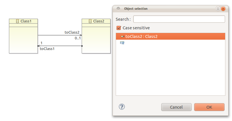

Initial state
index.php/fa/7109/0/
Empty list of candidate opposites (1 single item, coming from ?)

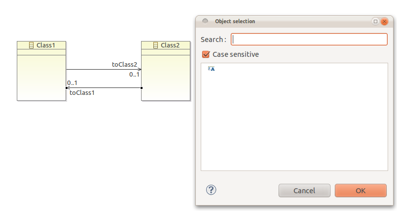

index.php/fa/7110/0/
After having changed one of the cardinalities, I can set the opposite :

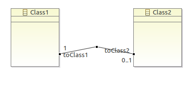

And the result is :
index.php/fa/7112/0/

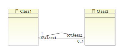

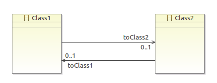

Once saved and reopened, I get :
index.php/fa/7113/0/
