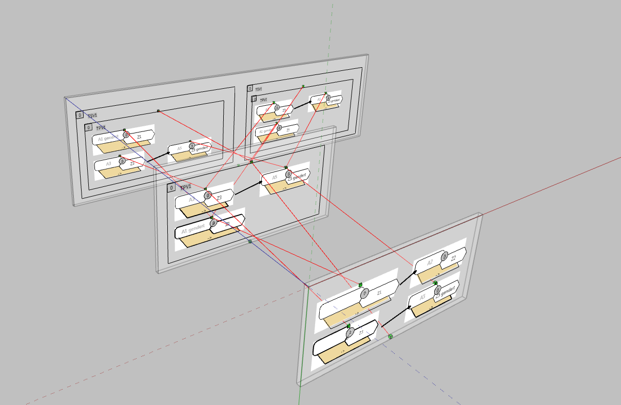

I am currently working on a visualisation of inter-model-connections. The background is copying complex objects where we store a reference from the copies to the copied objects. I need to visualise these references for debugging purposes .
Well, I was successfull in visualising the different objects by 3difying the available editors we implemented. Now, I am trying to display the intermodel-relations, i.e. the backreferences from copy to copy template.
I used the publications from the eclipse magazines and then found your example of displaying graphs: org.eclipse.gef3d.examples.graph . There I found the usage of InterModelContainer, this is in my implementation a TIReferenceModel, which is capable of computing the references from copy to copy template. The editPart for this is TIReferenceModelEditPart, which extends AbstractConnectionEditPart just like InterModelContainerPart does in the example. The Figure of this part is a TIReferenceModelFigure which extends InterModelDiagramFigure, just like in the example.
My TIReferenceModelEditPart returns all computed backreferences as modelChildren.
The desired behaviour for the creation of a MultiEditor is the following:
I open the editor on an object that has been copied (several times), the copies i call instances. These copies might have also been copied, thus there exist instances referencing the previous instances. This leads to a tree structure. The object I open the editor on is the root.
Now, for each node of the instantiation tree a 3dified editor will be added. This is executed successfully. Then, for each instance I compute a TIReferenceModel and add an Editor for this model.
This action results in a ClassCastException:
TIReferenceModelFigure cannot be cast to org.eclipse.draw2d.Connection.
It occures when I initialise the nested editor for for my TIReferenceModel (see below). My brute force attempt was to just let the figure implement Connection, which leads to an IndexOutOfBounds on the MultiModelContainerFigure (or sth. like that, sry, I cannot recall the name but it seemed to be the Figure of the MultiEditor's rootEditPart).
Well, I was wondering what I might be missing. I do get that the cast is not correct, but this results from the extension of AbstractConnectionEditPart. Why does this not lead to an error in your implementation, or rather what do I do different than you in the example.
What I see is different is that you only create one InterModelContainer whereas I create numerous and thus numerous nested editors for these containers are created.
Thanks a lot for any help provided!

Re: ClassCastException on extended InterModelDiagramFigure [message #789977 is a reply to message #789893] Fri, 03 February 2012 11:39 Go to previous messageGo to next message
Jens,
sometimes one is just a blockhead. Thanks for the explanation of the GEF connection behaviour. I was partly aware of it because I also had to debug this several times. The adapter pattern totally did the trick. I now create a standard additonal graph model (nodes and edges) for my connections and the container returns these adapters as modelChildren. The adapters know about their connections and everything works as expected (see below)! I did not spend much time on the rendering though. Our editors create figures with gradients and so on, but this is of minor interest. I had to see the reference to find out what my model looks like.
Thanks a million for your time.
I will work out a (simple) example stripped down to just these intermodelConnections and the addition of an InterModelContainer. I'll let you know as soon as it's finished.
Thx so much for GEF3D. Great framework!
Cheers, Lukas

Re: ClassCastException on extended InterModelDiagramFigure [message #790091 is a reply to message #789977] Fri, 03 February 2012 15:10 Go to previous messageGo to next message
Lukas,
that looks great, congratulations!
Cheers,
Jens
