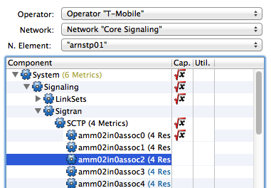

On MacOSX Lion, when I enable cell navigation. (From Snippet058CellNavigationIn34 ),
highlighting of non focus, but selected cells is not as expected. In the attached screenshot,
I am selecting multiple cells in column 0. The selection starts at the row named "SCTP".
What I observe:
- The selection is there, as I do get the multiple selected items.
- The highlighting is in background white, only for the text bounds of the cell.
- The foreground seems to be white as well, as the collapse/expand triangle is not visible for the row named "SCTP". (Note: I Use a StyleCellLabelProvider for the label and images).
What I would expect, is the multiple selection to be at least visible, I guess it can't be the same color as the selection of the focused cell, but a reasonable default should be to make clear it's selected.
What I would like, is to keep the default selection color, even for the focus cell, but then have the focus cell draw a dotted line or thicker border around the focus cell.
For the latter, I could implement my own FocusCellOwnerDrawHighlighter and re-implement markFocusedCell.
How do I change the multi-selection highlighting color to non-white?
Thank you,
Christophe Bouhier
[Updated on: Mon, 30 January 2012 07:58] by Moderator
Re: tree viewer, cell multi selection not highlighted. [message #786439 is a reply to message #786422] Mon, 30 January 2012 07:28 Go to previous messageGo to next message
There's a bugzilla with a solution for this already but I can't remember
the bugid.

Re: tree viewer, cell multi selection not highlighted. [message #786468 is a reply to message #786439] Mon, 30 January 2012 08:21 Go to previous messageGo to next message
thanks Tom. You mean this one?
223934
Re: tree viewer, cell multi selection not highlighted. [message #786477 is a reply to message #786468] Mon, 30 January 2012 08:37 Go to previous messageGo to next message
or this one, 197953 looks better.
Re: tree viewer, cell multi selection not highlighted. [message #786505 is a reply to message #786477] Mon, 30 January 2012 09:07 Go to previous messageGo to next message
I tried this, but it doesn't really work.
- up and dawn arrow keys are not working.
- selection is the full row, not the selected cell.
Re: tree viewer, cell multi selection not highlighted. [message #786508 is a reply to message #786505] Mon, 30 January 2012 09:08 Go to previous message
I meant 268135
Tom
