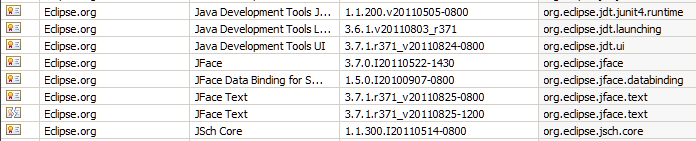

Then, I needed to change org.eclipse.jdt.ui. Similarly, it worked perfect inside the second eclipse (debugging). However, I am having problems with the deployment. I try the same trick for org.eclipse.jdt.ui, recompile it with a new version identifier, however for some reasons, when I move it under the dropins/ directory of another eclipse and restart that eclipse, it does not get loaded (my version).
I have attached a screenshot that shows the plug-ins that are currently running on my eclipse (partial). You can clearly see that I have two org.eclipse.jface.text running (my version and eclipse original), however for org.eclipse.jdt.ui, I only have one (original eclipse).
