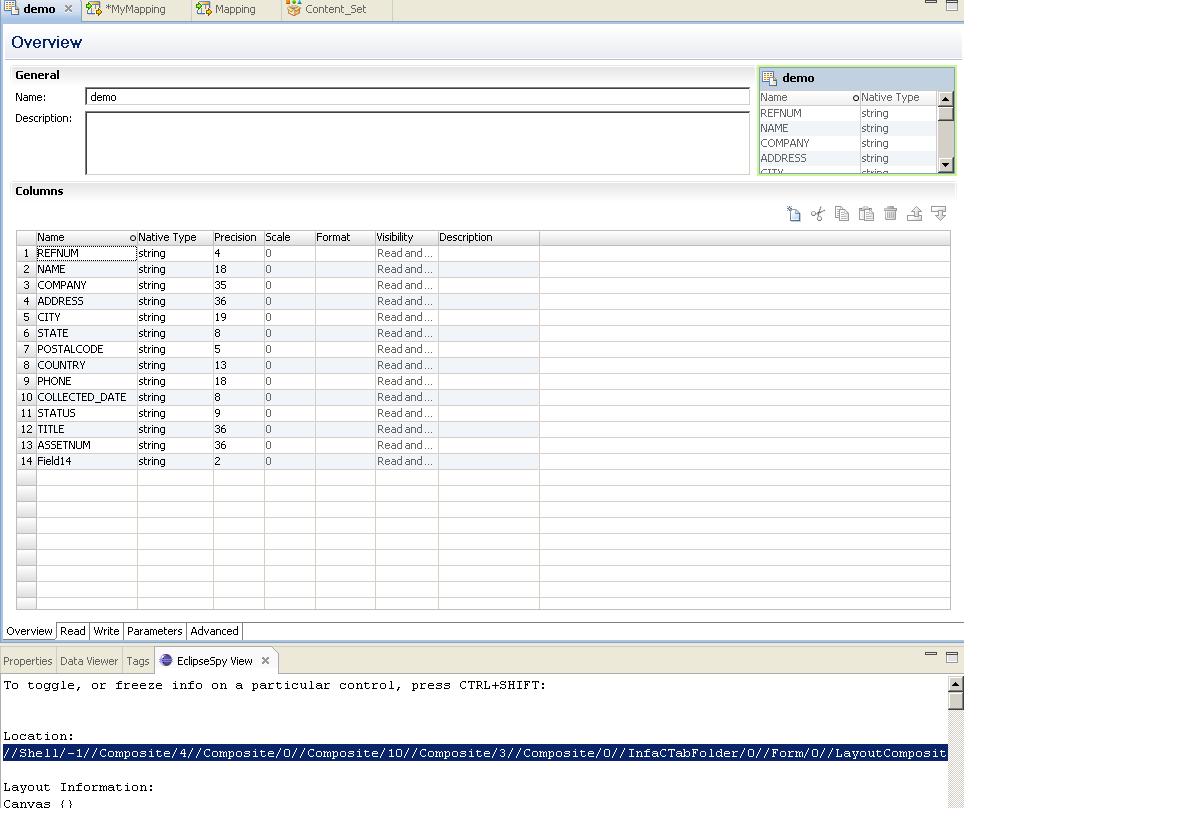

I am new to SWTBOT needed a help to automate the application for functional tests. Most of the widgets on my application when viewed from eclipse spy returns the widget as canvas. Below is an example. although i see that the parent object is an SWTTable. Can i operate on the the table? or is there any other way to edit this canvas.
I am also attaching the snapshot of the application for reference.
Any help on this will be very useful for me to go ahead with tests with swtbot.
//Shell/-1//Composite/4//Composite/0//Composite/10//Composite/3//Composite/0//InfaCTabFolder/0//Form/0//LayoutComposite/1//Section/1//LayoutComposite/1//SWTTable/1//Canvas/0
If you have a SWTBotTable tableBot, you can operate with the underlying
Table widget using tableBot.widget. It may require you to run your
operations in a UIThread.
HTH
