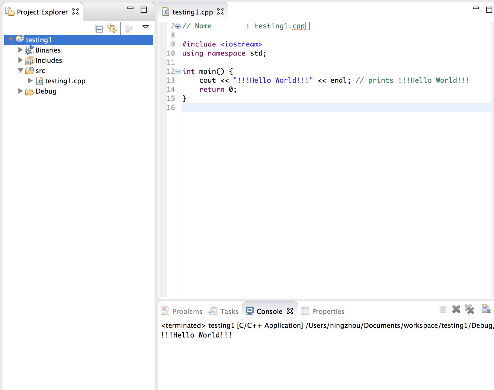

Re: Newbie Help: "Launch failed. Binary not found." for c++ on Mac OS X 10.7 Eclipse Indig [message #1600149 is a reply to message #785248] Tue, 03 February 2015 22:53 Go to previous messageGo to next message
Yes, this is how I resolved my problem.
I have a maverick.
I already tried to install the new common line tool from the Apple App Developer. It didn't work even if I chose MAC GCC.
I checked if I have my GCC. I have it. This is command is quite powerful.
Re: Newbie Help: "Launch failed. Binary not found." for c++ on Mac OS X 10.7 Eclipse Indig [message #1600150 is a reply to message #785248] Tue, 03 February 2015 22:55 Go to previous message
Just use Command+B, and you can build all of them without knowing the binary files.
You should check if you have gcc with this command:
sudo ln -s /usr/bin/gcc
the result should be
ln: ./gcc: File exists
If needed, you also need to download Command Line Tools, but I don't see it is needed.
