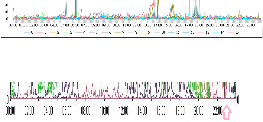

I have to create a chart-report, which shows the usage of all CPUs of an server.
The chart will be send every moning with the data from the day before.
The date is collected every 5 minutes.
When I create the report, I have lots of bars in the x-axis (one for each 5minutes), but I just want to see the lines, which belong to the hours ( 0:00 to 23:00 ). Look at attached picture.
index.php/fa/6830/0/
I have no possibility to change the scale from the x-axis (everything is grey and not chooseable)
Do you have any ideas?

Look at the second tab of the chart wizard. Select the grouping and
sorting icon next the the Category (X) Series data field. When the
Group and sorting editor is displayed click on the Grouping Enabled
check box and set the type to Date Time and set the unit to hours. You
may also want to set the interval to 1.
Jason
