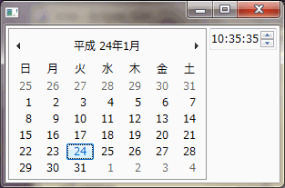

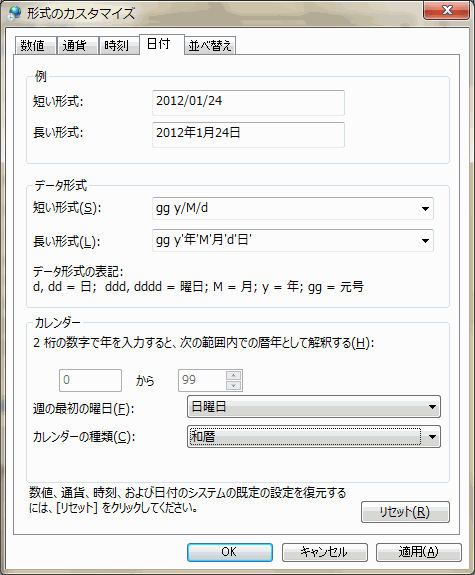

Re: Japanese Imperial Calendar support [message #782589 is a reply to message #782225] Mon, 23 January 2012 21:09 Go to previous messageGo to next message
It works for me on Windows 7.
DateTime widget is based on Windows' Calendar control, I guess.
Japanese Imperial Calendar is supported from Java6 but it is not related to SWT.
>Locale localeImperialJapanese = new Locale("ja", "JP", "JP");
>Locale.setDefault(localeImperialJapanese);
This has no sense for the DateTime widget.
attached: settings and the result of Snippet250.

icon14.gif  Re: Japanese Imperial Calendar support [message #784179 is a reply to message #782589] Fri, 27 January 2012 01:43 Go to previous message
Thanks a lot. I missed a setting in the control panel.
