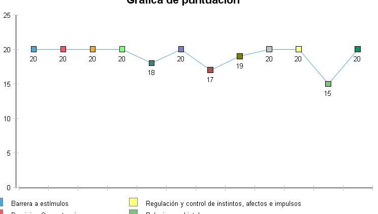

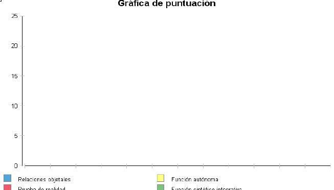

icon5.gif  Chart incomplete in PDF [message #780666] Wed, 18 January 2012 18:00 Go to next message
Hello Community
I have a problem with my BIRT, i'm working in a report to pdf who includes a chart, i'm using scripted datasource...
I have two dataset, one of them should fill the chart's information
I'm sure that both datasets contains information because i put this fields in other section in the report and works ok, show the correct information, but for the chart, i put one field to x-axis and another to y-axis, but only the x-axis are correctly filled, not sure what's the problem...
In 'view report' and 'preview' the chart works ok...
Can you please help me ??
Any ideas??
Thanks a lot!!
  • Attachment: inPDF.jpg
    (Size: 13.24KB, Downloaded 277 times)
  • Attachment: inPreview.jpg
    (Size: 20.77KB, Downloaded 270 times)

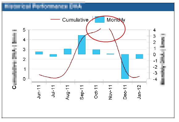

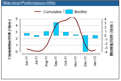

Re: Chart incomplete in PDF [message #788491 is a reply to message #780892] Wed, 01 February 2012 16:58 Go to previous messageGo to next message
I am using Birt 2.5.1.
For some reason, some of the chart is not properly showing in PDF while its working perfectly in html. I notice that in html display chart y-axis showing correct label
while in pdf it shows different.
I used scripted data source and chart is in png format.
Please help !
PDF
index.php/fa/6975/0/
HTML
index.php/fa/6976/0/
Thank you

row["sectionChart"] = stock.get(count).getSectionName();
row["resultChart"] = stock.get(count).getSectionResults();
count++;
return true;
return false;
The column named 'puntuationChart' is the problem.... This column is type=Decimal, and I filled it with a POJO's property type = double, just like this example http: //www.vogella.de/articles/EclipseBIRT/article. html (I did the example and works fine).

When I execute the proyect, get this warning:
Feb 14, 2012 3:10:30 PM org.eclipse.birt.chart.internal.datafeed.ResultSetWrapper initializeMeta
WARNING: Unable to determine data types from resultset
But this warning only is showing when the project is executed, when use the BIRT preview works fine
Could you please help me?
Attached the XML Design
Re: Chart incomplete in PDF [message #799221 is a reply to message #798575] Wed, 15 February 2012 11:11 Go to previous messageGo to next message
Can you add the following to your fetch:
if(count < stock.size()){
importPackage( Packages.java.io );
out = new PrintWriter( new FileWriter( "c:/temp/datasetevents.txt",
true ) );
out.println( "puntuationChart "+count+"--" +
stock.get(count).getSectionPoint());
out.close();
row["puntuationChart"] = stock.get(count).getSectionPoint();
count++;
return true;
And then verify all the data in the datasetevents.txt file?

Re: Chart incomplete in PDF [message #800176 is a reply to message #799381] Thu, 16 February 2012 14:44 Go to previous messageGo to next message
Try leaving it at a string in the java code:
change this code.
double point = Double.parseDouble(answersStr[s]);
to just return a string for the point. Also if you delete the tables
and only have the chart does it work?
I noticed in your table you changing the type to integer.
Jason

Hi Jason, thanks a lot but...
Still not working, i changed the datatype as String (for all the columns), got the same error:
Feb 16, 2012 4:59:02 PM org.eclipse.birt.chart.internal.datafeed.ResultSetWrapper initializeMeta
Something that i forgot mention is that 'Point' is the data for Axis-Y, Axis X is filled correctly with column 'Section'
Ammm, the chart does not work, with or without tables
I try restarted a new report from the beginning, really don't understand why doesn't work.... Confused
Attached the rptdesign
