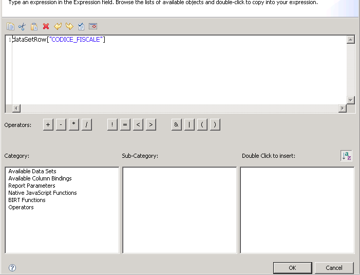

I see this if I use expression builder with a data item
index.php/fa/6795/0/

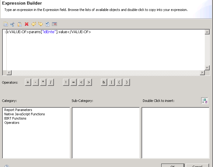

but i see this if I use expression builder with a test item
index.php/fa/6796/0/
So I can use data items, but not use dynamic text

Re: Data set in dynamic text [message #781149 is a reply to message #780907] Fri, 20 January 2012 12:57 Go to previous messageGo to next message
Is the dynamic text field in a table?
Jason

Re: Data set in dynamic text [message #782723 is a reply to message #781149] Tue, 24 January 2012 04:52 Go to previous message
OK, that's the problem, the text item was out of a table
