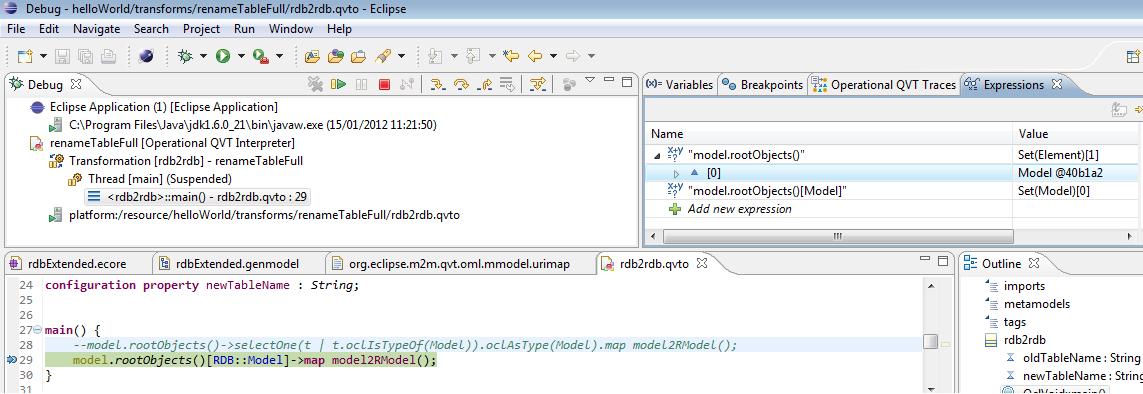

Hi all,
Sorry for my English, I am beginner.
I have a problem with the use of a metamodel in workspace from a QVTO' transformation.
I have defined the following mapping:
<mapping sourceURI="rdbExtended/rdb" targetURI="platform:/resource/rdbExtended/model/rdbExtended.ecore"/>
And this is a piece of my transformation:
modeltype RDB uses 'rdbExtended/rdb';
--IN THIS WAY DOES NOT WORK:
--modeltype RDB uses 'platform:/resource/rdbExtended/model/rdbExtended.ecore';
transformation rdb2rdb(inout model: RDB);
main() {
  model.rootObjects()[RDB::Model]->map model2RModel();
THE PROBLEM IS THAT THE DEBUGGER SAYS THE Set 'model.rootObjects()[RDB::Model]' IS EMPTY, BUT ACTUALLY MY MODEL HAS AN ELEMENT OF TYPE Model.
See the attached image.
index.php/fa/6743/0/
This works if I use:
modeltype RDB uses 'ht..://www.eclipse.org/qvt/1.0.0/Operational/examples/rdb';
Thanks, Regards.
Gustavo.
  • Attachment: qvto.jpg
    (Size: 85.91KB, Downloaded 1107 times)

Hi Gustavo
I suspect that you have my 'favourite' problem; meta-model schizophrenia.
You are referencing the same meta-model by two different names and so
you have two distinct copies. You loaded a 'left-hand' Model but are
transforming 'right-hand' Models.
Make sure you only use one of platform: ... or http: ... of file:... to
reference it.
Ed Willink

Thanks Ed,
In this case the problem was the use of dynamic instances.
I built an editor for my local metamodel.
Then create an instance using the editor, and the transformation worked!
