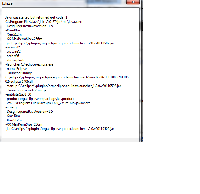

By running the following command on command prompt
eclipse -vm C:\Program Files\Java\jdk1.6.0_27\jre\bin\javaw.exe
I am getting a error.The snapshot of error is attached.
Please Help

What do you mean by "has stopped working"? Has it ever worked for you?
Is this a Windows 7 64-bit installation? Follow instructions at
http://wiki.eclipse.org/Eclipse.ini to set up eclipse.ini correctly.
Ensure also that you're not trying to run a 32-bit Eclipse on a 64-bit JVM.

Good. Now that we've settled that, how about your eclipse.ini file? Why
not paste that in here for us to inspect?

On 01/16/2012 10:35 AM, Prerna Golani wrote:
> eclipse.ini
> -startup
> plugins/org.eclipse.equinox.launcher_1.2.0.v20110502.jar
> --launcher.library
> plugins/org.eclipse.equinox.launcher.win32.win32.x86_1.1.100.v20110502
> -product
> org.eclipse.epp.package.jee.product
> --launcher.defaultAction
> openFile
> --launcher.XXMaxPermSize
> 256M
> -showsplash
> org.eclipse.platform
> 256m
> -vm
> C:\Program Files\Java\jdk1.6.0_27\jre\bin\server\jvm.dll
> openFile
> -vmargs
> -Dosgi.requiredJavaVersion=1.5
> -Xms40m
> -Xmx512m
Get rid of the blank line before the -vm.
Change the next line to be:
C:\Program Files\Java\jdk1.6.0_27\bin\javaw.exe
