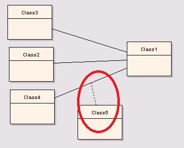

Sorry, I guess I didn't explain my self very well. I've attached a
figure which shows what I'm talking about. I have a set of figures and
three are connected to one. I would like to annotate (e.g., name) the
connections unambiguously like the attached.
I can definitely add labels to connections, but when I have a large
number of connections with a common target figure, the labels on the
connections are a bit muddled.
The attached figure shows sort of what I would like to do. I would like
to attach a label to a connection but then have some sort of visual
'connection line' between the label and its owner (connection figure).
Hope this makes sense.
r
