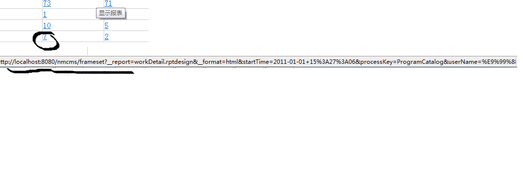

hello, I wonder how should I do to hide drill-through hyperlink informaion in dril-through birt report?
description:
I view a drill-through Birt report with frameset servlet in IE. When mouse over the link, the hyperlink infromation will show on status label. Think about security, I want to hide these hyperlink information, how should I do?
with set html code onmouseover can hide the status info.
<a herf="" onmouseover="window.status='';return true" />
But how do I set onmouseover attribution on each hyperlink?
Is there some configuration to void show these hyperlink information?
image:
index.php/fa/6670/0/
  • Attachment: 钻取.png
    (Size: 16.44KB, Downloaded 1890 times)

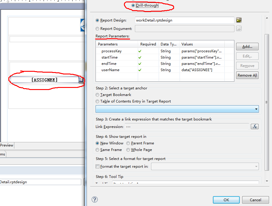

In my case, I used "Drill-through" and passed Cell's value to child report. The url hyperLink information is auto generated by render report.
It seems that I can't rewrite tag A's href value.
my drill-through report
index.php/fa/6689/0/
How should I do to hide the gernerated reports' hyperlink information?
to be more suitable show like "javascript: openwindow('some pass value')"
Bruce
> Regards,
> Bruce

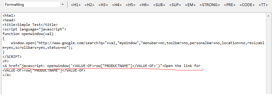

Thanks for your help. My problem has done, by used a text element with <JavaScript> function codes to set hide <a> tag, without use of drill-through.
Under is my tested JS codes in the text element.
<html>
<head>
<title>Simple Test</title>
<script language="javascript">
function openwindow(val)
	window.open("/nmcms/frameset?__report=customerDetail.rptdesign&__format=html&customName="+val,
		"myWindow",
		"menubar=no,toolbar=no,personalbar=no,location=no,resizable=yes,scrollbars=yes,status=no");
</SCRIPT>
</SCRIPT>
<P>
<A href="javascript: openwindow('<VALUE-OF>dimension["Group1"]["CUSTOMERNAME"]</VALUE-OF>')">
</A>
In my opinion, if the "drill-through" supply an option to set hyperlink show detail would be better Smile
Looking forward to your suggestion.
Bruce

Re: How to Hide drill-through hyperlink information? [message #778408 is a reply to message #778287] Thu, 12 January 2012 10:59 Go to previous messageGo to next message
Bruce,
The solution you came up with is a good one. It would be good to log an
enhancement in bugzilla to hide the status or obfuscate the url in drill
throughs.
Jason
