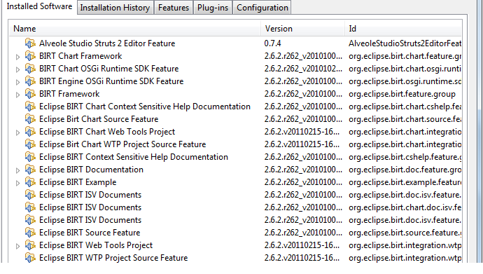

I have installed BIRT today and the installation was successfull, asked me o restart the eclipse once the installation was completed. But after restarting the eclipse, i am not able to find the BIRT folder/project when i try to create a new project.
When i checked the installed softwares then i can see all the BIRT is installed. Have a look at the attachment. Please suggest if i am missing something. Please inform how to create the new BIRT project.

Do you have the following installed as well?
Eclipse Version 3.6.2 SDK
DTP Version 1.8.2
EMF Version 2.6.1 Release EMF+XSD
GEF Version 3.6.2 runtime
WTP Version 3.2.3
BIRT 2.6.2 requires these.
Jason

I am using eclipse IDE 3.7. Do i need to install Eclipse Version 3.6.2 SDK also? I mean does the SDK comes along with the IDE or i need to install this as well since i cant find an entry of the SDK in the list of installables.
No i don't have the list you provided installed. Please inform from where to get this. Should i install them individually or i will get all of them in a single package? I am not able to find them, hence asked you about the links where i can get them.

You should be able to get these individually from the update site.
You can also download the allinone download that has Eclipse/Birt and
all the dependencies included.
Jason
