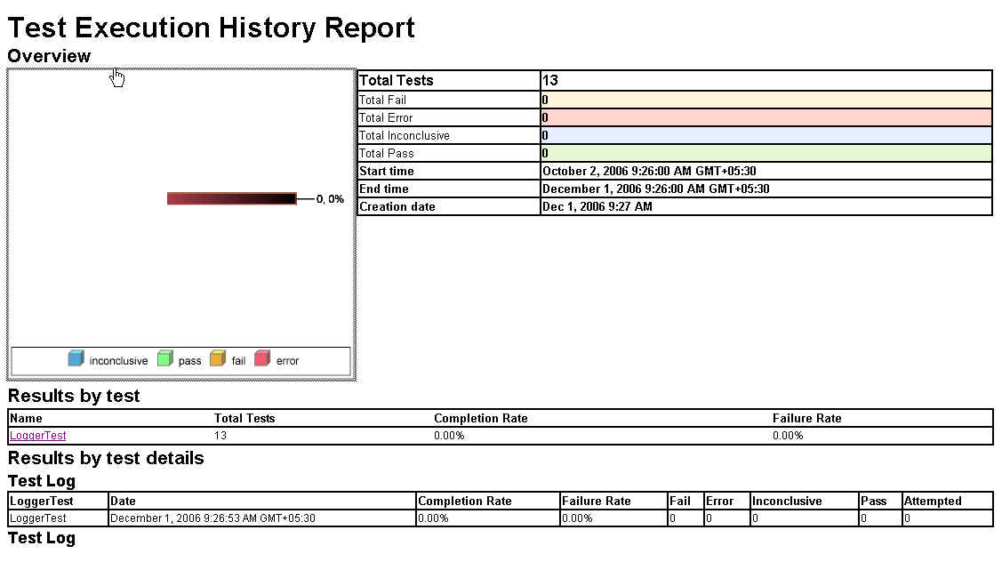

Re: TPTP Test Results with "no verdict" while Total test performed reported [message #89165 is a reply to message #89150] Thu, 30 November 2006 23:10 Go to previous messageGo to next message
Originally posted by: jaikumar.sharma.barco.com
Hi Liz,
Thanks for your response. Actually I execute JUnit tests headless using
TPTP, when I execute JUnit tests in Eclipse UI, I always get 100 percent
pass result, but when I try to execute the testsuite headless then at times
(randomly) I get the Test Execution History report like (which is attached)
in which Total test are reported, but no verdict appears -- either it is
pass or fail or error .. etc.

Re: TPTP Test Results with "no verdict" while Total test performed reported [message #89446 is a reply to message #89165] Tue, 05 December 2006 16:17 Go to previous messageGo to next message
Hi Jaikumar,
Do you know if the test execution histories contain the correct
verdict? I want to know if this is the problem with the report or the
execution histories are not recording the correct verdict.
Does your junit test reference other junit tests?
Sheldon.

Re: TPTP Test Results with "no verdict" while Total test performed reported [message #89462 is a reply to message #89446] Tue, 05 December 2006 23:10 Go to previous messageGo to next message
Hi Sheldon,
Thanks for respone!
I think execution history does not contain correct verdict. I can see the
following contents in the file -- ResourceContents inside
LoggerTest.execution as as a result of running LoggerTest.testsute.
____________________________________________________________ ____________________________________________________________
<Common_Testprofile:TPFExecutionResult xmi:version="2.0"
xmlns:xsi="http://www.w3.org/2001/XMLSchema-instance"
xmlns:Common_Testprofile="http://www.eclipse.org/hyades/models/common/testprofile.xmi"
id="F783B9E0EA62B0BFE2A28BB0837411DB" name="LoggerTest"
type="org.eclipse.hyades.test.java.junit.testSuite">
<executionHistory>
<executionEvents xsi:type="Common_Testprofile:TPFMessageEvent"
timestamp="1165376663689"
text="System.out:&#xA;log4j.properties&#xD;&#xA; "/>
</executionHistory>
<test xsi:type="Common_Testprofile:TPFTestSuite"
href=" src/com/barco/cmstest/foundation/logging/LoggerTest.testsuit e#F783B9E0EA62B0BFE2A28BB0837411DB "/>
</Common_Testprofile:TPFExecutionResult>
____________________________________________________________ ____________________________________________________________ __
My JUnit test does not refer to other JUnit tests. Kindly let me know, in
case you need further info.
Jaikumar

Re: TPTP Test Results with "no verdict" while Total test performed reported [message #89549 is a reply to message #89462] Wed, 06 December 2006 14:28 Go to previous messageGo to next message
Would it be possible to email me the .execution file and .testsuite
file to me directly.
Also are you running the testsuite within an eclipse environment or
via an ant script.
email: sleeloy@ca.ibm.com
Sheldon.

>> On Fri, 1 Dec 2006 09:40:50 +0530, "Sharma, Jaikumar"
>> <jaikumar.sharma@barco.com> wrote:
>>>Hi Liz,
>>>times
>>>attached)
>>>Regards,
>>>Jaikumar
>>>"Liz Dancy" <lizdancy@ca.ibm.com> wrote in message

>>Hi Sheldon,
>>Thanks for respone!
>><?xml version="1.0" encoding="UTF-8"?>
>>xmlns:xmi="http://www.omg.org/XMI"
>> <executionHistory>
>> </executionHistory>
>>Regards,
>>Jaikumar
