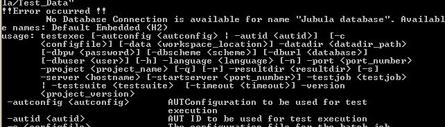

but I get an error message saying that no database connection is available for name "Jubula database" and that the only available name is "Default Embedded (H2)" (see screenshot Jubula_Database_120103_2.jpg). I have also tried with dbscheme = "PostGreSQL", but without any luck. What should dbscheme be specified as? See screenshot Jubula_Database_120103_1.jpg for database preferences.

Re: Problem starting a test suite from command line [message #774558 is a reply to message #774267] Wed, 04 January 2012 02:08 Go to previous messageGo to next message
-dbscheme is required as argument by "testexec", so I have to solve that problem first in some way.

Re: Problem starting a test suite from command line [message #774648 is a reply to message #774558] Wed, 04 January 2012 05:39 Go to previous messageGo to next message
Hi Richard,
The reason that the dbscheme cannot be found is probably because the -data parameter is missing. The -data parameter specifies the workspace, which is the place checked for the database preferences.
Alex

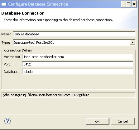

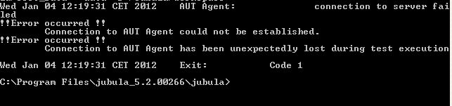

Now I get "AUT agent: conection to server failed" (see screenshot Jubula_Database_120103_3.jpg). Is there any way to get some detailed information about what's causing the server connection problem?
One thing I have in mind is that I haven't specified the database name "jubula" anywhere (see Jubula_Database_120103_1.jpg) and what I can see there's no option to do that when calling "testexec". Isn't that necessary?
Regards Richard
Re: Problem starting a test suite from command line [message #774691 is a reply to message #774673] Wed, 04 January 2012 07:13 Go to previous messageGo to next message
The error message
means that the connection couldn't be made to to AUT Agent. Either you've not started one on the port you're using, or something else (perhaps the ITE? Wink ) is already connected to it.
Alex
Re: Problem starting a test suite from command line [message #775054 is a reply to message #774691] Thu, 05 January 2012 03:18 Go to previous messageGo to next message
Sorry but I can't get this to work.
This is what I try to run in command line (dbpw is replaced by XXX):
testexec -project "Jubula Test" -version "1.0" -testsuite "TEB" -autconfig "EBITool-7.0_TEB@localhost" -resultdir "D:/Jubula/Result" -language "sv_SE" -dbscheme "Jubula database" -dbuser "rskoog" -dbpw "XXX" -server "liono.scan.bombardier.com" -port "60000" -datadir "D:/Jubula/Test_Data" -data "D:/Jubula/Workspace"
but I still get "AUT Agent: connection to server failed". All according to screenshot Jubula_Database_120103_3.jpg.
I can't understand this because the connection to the AUT agent is up and running. I have connected via localhost without changing any port, so I guess that the port in command line should be 60000 (see screenshot Jubula_Database_120103_4.jpg).
Exactly what shall be done before I run command line? What shall be started and what shall not be started?
Regards Richard
Re: Problem starting a test suite from command line [message #775109 is a reply to message #775054] Thu, 05 January 2012 05:39 Go to previous messageGo to next message
The fact that you are already connected to the Agent process is the problem. The Agent only accepts one connection, and this is already in place. Disconnect from the Agent via the ITE and then the testexec process will be able to connect to the running Agent.
Alex

Re: Problem starting a test suite from command line [message #775205 is a reply to message #775158] Thu, 05 January 2012 10:00 Go to previous messageGo to next message
Try using
-server localhost
instead of
for your AUTagent connection (assuming that the AUT should run on localhost). Maybe there is a typo in the hostname.
- Achim
Re: Problem starting a test suite from command line [message #775211 is a reply to message #775158] Thu, 05 January 2012 10:12 Go to previous messageGo to next message
Hi Richard,
How are you checking that the port used is 60000 as described in the second step? Your attachment Jubula_Database_120103_4.jpg shows the ITE as being connected to the Agent. The testexec you are starting is also going to want to connect to that Agent, so this connection cannot still be in place when you want to start the testexec.
Bear in mind as well that nothing should happen in Jubula when the testexec connects to the Agent or runs the test. The testexec offers the same functions as the ITE for executing tests, but does not require or affect the GUI in any way.
I noticed from your command that you entered liono.scan.bombardier.com as the server. Is this the hostname for the AUT Agent? If not, then this could be a reason.
Alex
Re: Problem starting a test suite from command line [message #776731 is a reply to message #775211] Mon, 09 January 2012 02:09 Go to previous messageGo to next message
Thanks for all the help!! It was the "server name" that caused the problem. Now it works!

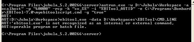

Re: Problem starting a test suite from command line [message #855148 is a reply to message #855088] Tue, 24 April 2012 11:07 Go to previous messageGo to next message
Most likely my fault, but I can't get the workaround to bite.
I'm running this:
autrun.exe -w D:\Jubula\Workspace -a "localhost" -p "60000" -rcp -k "sv_SE" -i "EBITool_AUTID" -e C:\Programs\Bombardier\EBITool-7.0\myebitoolscript.cmd -g "true"
The myebitoolscript.cmd looks like this:
ebitool.exe -data D:\Workspaces\EBITool\CMD_LINE
but I get the erros according to the attached snapshot.
This one works, but without setting the workspace due to bug 346572:
autrun.exe -w D:\Jubula\Workspace -a "localhost" -p "60000" -rcp -k "sv_SE" -i "EBITool_AUTID" -e C:\Programs\Bombardier\EBITool-7.0\ebitool.exe -data D:\Workspaces\EBITool\CMD_LINE -g "true"
Any ideas?
Regards Richard
  • Attachment: Jubula.jpg
    (Size: 29.17KB, Downloaded 364 times)
Re: Problem starting a test suite from command line [message #855880 is a reply to message #855148] Wed, 25 April 2012 03:19 Go to previous messageGo to next message
Could you try putting the -e argument and its parameter at the end of the command line? I believe that -e has to be the last argument, otherwise any following parameters are interpreted as being parameters of the AUT.
Does that help?
Alex
Re: Problem starting a test suite from command line [message #855992 is a reply to message #855880] Wed, 25 April 2012 05:14 Go to previous messageGo to next message
Unfortunately not Sad
I tried:
autrun.exe -w D:\Jubula\Workspace -a "localhost" -p "60000" -rcp -k "sv_SE" -i "EBITool_AUTID" -g "true" -e C:\Programs\Bombardier\EBITool-7.0\myebitoolscript.cmd
but with the same result. Does it really work for you to use the workaround?
Regards Richard
Re: Problem starting a test suite from command line [message #856027 is a reply to message #855992] Wed, 25 April 2012 05:51 Go to previous messageGo to next message
I've seen the problem now. Your working directory is wrong. When you use -e without the .cmd, then you place the absolute path in front of the .exe. When you use the script, you enter the absolute path for the script, but inside the script you have a relative path - relative to the working directory. autrun is looking for your application under D:\Jubula\Workspace\ebitool.exe.
Alex
Re: Problem starting a test suite from command line [message #856129 is a reply to message #856027] Wed, 25 April 2012 07:49 Go to previous message
