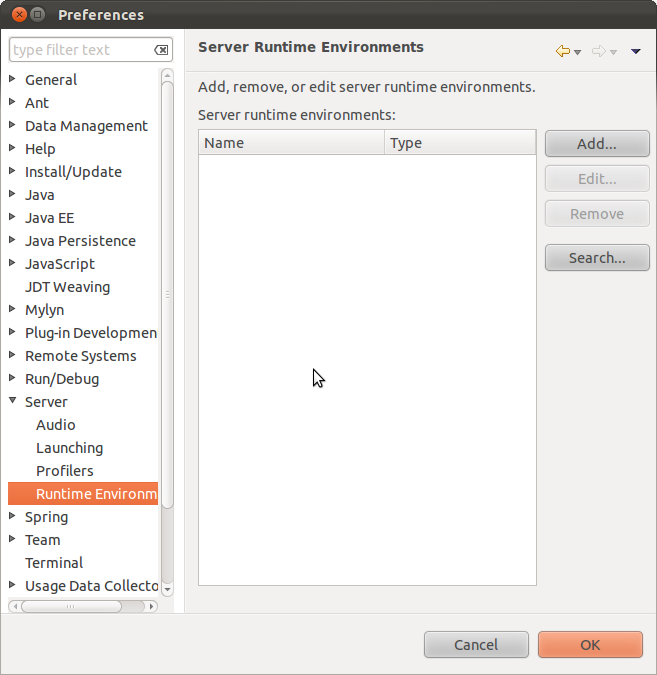

I removed all server runtime instances from Windows->preferences->Server->Runtime Environments
Still when I click on Server tab & try to add a tomcat 6 server, it does not let me
"Cannot create a server using the selected type"

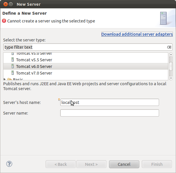

Here is the screenshot
I can select all other tomcat versions fine.
http://img845.imageshack.us/img845/9352/tomcat6error.png

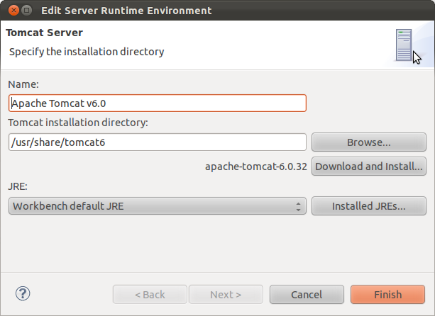

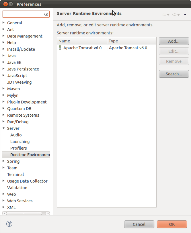

icon13.gif  Re: Problem adding tomcat6 server instance back in eclipse [message #772106 is a reply to message #772073] Wed, 28 December 2011 21:17 Go to previous messageGo to next message
No, it does not help.
I created tomcat 6 runtime in server preferences & tried to add the server.
