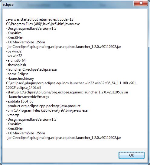

I changed the eclipse.ini to include the location of the JVM and here's the new error in the image associated...
  • Attachment: Eclipse.jpg
    (Size: 74.77KB, Downloaded 269 times)

On 2011.12.28 10:20, Ziad Akiki wrote:
> I'm getting a new error: "Java was started but returned exit code = 13"
This may be that you're attempting to pair an Eclipse download and a
JDK/JRE of dissimilar bittedness. Ensure that you've got both a 32-bit
Eclipse and 32-bit JRE or a 64-bit Eclipse and 64-bit JRE.
