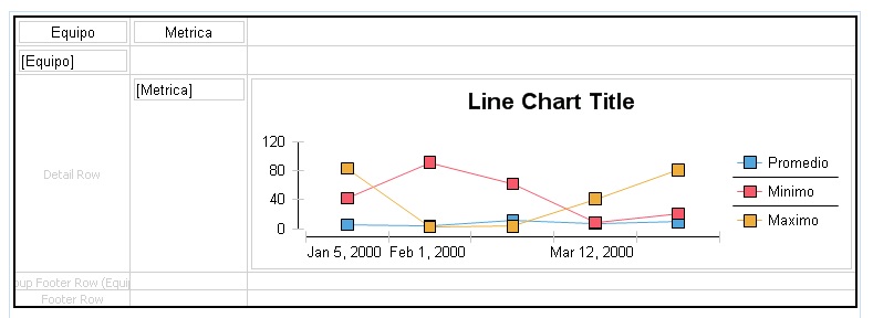

What I need to do is graph this information for each server, therefore I created a Table (grouped by server) like the attached file (report.jpg). It is in spanish but equipo=server, metrica=metric, promedio=average.
The resulting table has all the servers and all the metrics, but the graphics are not appearing. I tried the graph separatedly (changing the paremeter for values and it worked ok). What can be wrong? I´m not receiving any errors during the execution, so I have no idea where the problem is.

You have sqlserver as one of the data sources. I did notice in the
first chart you did not bind your dataset parameters. Select the chart
and in the properties view look at the binding tab and click on the Data
Set Parameter Binding button, next click on the fx button and select the
values from the outer dataset to set the parameters for each instance of
the chart.
Jason

Yes you have the chart bound to the dataset but no parameters set for
it. Did you see the Data Set Parameter Binding... button? If you click
on it you can set the value for the inner data set. Take a look at the
attached example for more clarification. The table with the red box
uses a data set that needs a parameter. The parameter is set based on
an outer table column value.
Jason

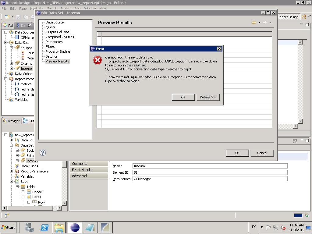

Sorry for the delay in my answer. I tried creating a new report as the nested you attached (which works ok) is but I can´t get it working. I noticed in the inner dataset the parameter is not bounded to the report parameter, but my inner datasource is throwing me an error that it cannot fecth the next row (see attached screen).
I´m also attaching you the report so you can take a look at it. I don´t know where the problem is.
