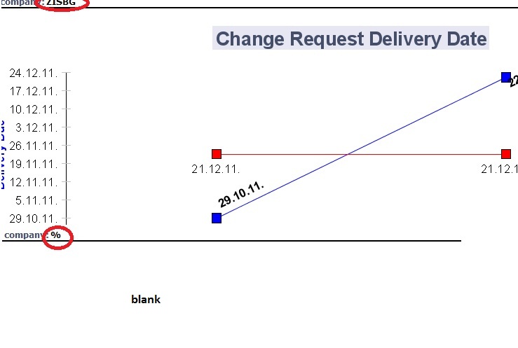

I use parameter in some data set which asks for the name of the COMPANY and result is some graphic (not list table result).
When I use only one company graphic is correct.
But when I use % for displaying all companies the result is blank graphic. Does this cant be done through the parameters - for graphic results?
Parameter is defined as required and string text box, and data set is calling parameter COMPANY like ?
index.php/fa/6524/0/
Thanks again

Can you post the report? You may want to add a table for testing to see
if the dataset is returning values. I am attaching an example that
uses a like query.
Jason

Re: How to calculate SUM cumulative times type of string? [message #772693 is a reply to message #768509] Fri, 30 December 2011 06:23 Go to previous messageGo to next message
Hi Jason,
sorry I can not open your example. Here is my report if you can find the problem. When I use ? to select all companies I am getting blank result.
I think that data set is OK in general, probably it is the problem with like query.
Thanks for help

I did not see any like clauses in your query. In my example I use:
select *
from products
where productname like ?
You may also want to verify that you have the string quoted like:
select *
from products where productcode like'%'
Jason
