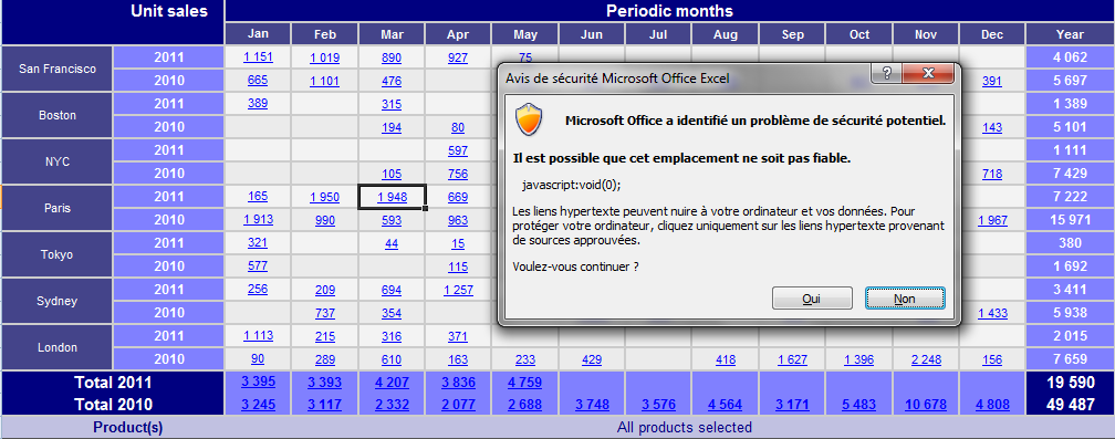

indeed that's much better: with javascript:void(0), at least Adobe or Excel won't try to open a browser if a user click on hyperlinks. Moreover, on mouseover on these links, users now won't see a a huge URL, but just a small javascript tooltip. So i will let it like that, though it's still not ideal: for PDF it's ok, but for example in Excel it may confuse users when they try to select cells range in a crosstab, as shown in screen below it displays a security warning and tries to download a file named void(0):
index.php/fa/6505/0/
