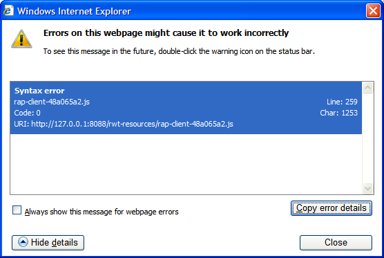

When loading my RAP application (which was developed on 1.3, migrated to 1.4 and now going to 1.5) I get a javascript error. the application continues to function correctly as far as I can tell.
I have attached the error dialog and the generated JS file.
I'm using the 1.5M4 build.
I don't get this issue when loading the RAP workbench demo or controls demo.
The code on line 259 is the UICallback code. The UICallback functionality is working correctly as far as I can tell. It may be a syntax error on one of the UICallback responses and IE8 is just referencing the Processor.processMessage(b) call in the error message.
Any assistance would be appreciated.

last week we fixed some typos in the UICallBack.js. Could you try the
latest nightly build? If the error persists, please create a snippet to
reproduce the error and open a bugzilla the track the progress on the issue.

I also ran into this problem. And found the source of it. I opened a bug for this: https://bugs.eclipse.org/bugs/show_bug.cgi?id=367053
