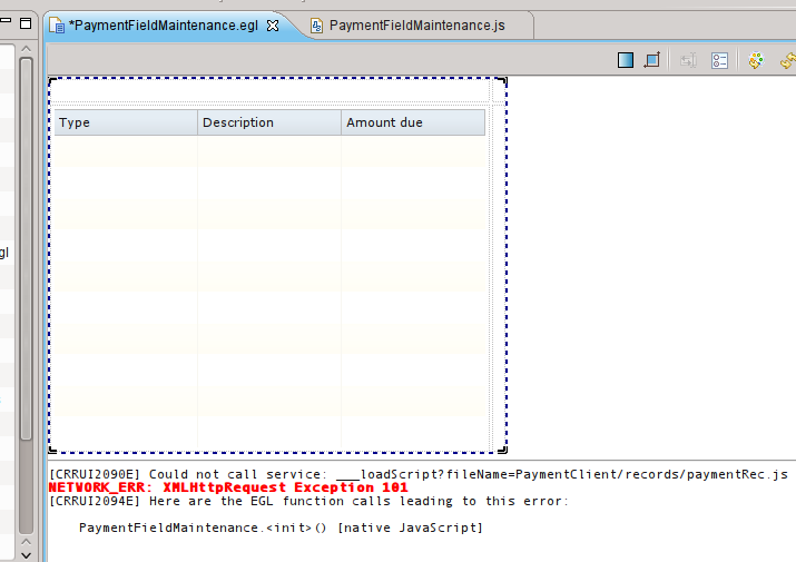

I am working through the EDT tutorial and am running into an error in section "Create a data grid to hold a set of database rows" of lesson 4. After creating the new EGL variable (allpayments) with the EGL Rich UI Data Wizard, this message text shows up under the GridLayout(ui) in the Design view of PaymentFieldMaintenance.egl:
[CRRUI2090E] Could not call service: ___loadScript?fileName=PaymentClient/records/paymentRec.js
NETWORK_ERR: XMLHttpRequest Exception 101
[CRRUI2094E] Here are the EGL function calls leading to this error:
PaymentFieldMaintenance.<init>() [native JavaScript]
I've attached a screenshot. I'm kind of lost here. I don't see a records/paymentRec.js file in my PaymentClient project (or any generated JS for that matter), but it looks like I can continue on with the tutorial. I was able to drag the allpayments variable to the GridLayout. Am I missing something?
I am running the EDT IDE on 64-bit openSUSE 12.1 with Tomcat 7.0.23 and Java JDK 7.0.1_01, against DB2 on IBM i 7.1. The JTOpen JDBC driver seems to be configured properly as I am able to ping the DB and was able to create the payments table as described in the tutorial.
Thanks for any assistance.
Blake

Re: EDT:Tutorial: RUI With DataBase Lesson 4 problem [message #766555 is a reply to message #766517] Thu, 15 December 2011 20:09 Go to previous messageGo to next message
Blake,
Could you please tell me which project the paymentRec is created?
The paymentRec should be created in PaymentShared project, you can find the JS file for paymentRec is generated under the project. PaymentClient should have a project reference to PaymentShared, and then PaymentFieldMaintenance can resolve the paymentRec.
Rocky
Re: EDT:Tutorial: RUI With DataBase Lesson 4 problem [message #766828 is a reply to message #766517] Fri, 16 December 2011 08:54 Go to previous messageGo to next message
Hi Blake,
First of all EDT automatically generates JavaScript when you save changed EGL parts in a project for which the JavaScript generator is selected. These parts are hidden in the project explorer when you are using the EGL perspective. If you switch to the Resource perspective, you will be able to see them in a project folder named "generatedJavaScript".
Please check that:
1. You have defined the record part records.paymentRec in the PaymentShared project.
2. File records.paymentRec.js has been generated into the PaymentShared project.
3. Project ProjectClient includes project PaymentShared in its EGL Build Path property.
4. File PaymentFieldMaintenance.egl includes this import statement:
import records.paymentRec ;
Re: EDT:Tutorial: RUI With DataBase Lesson 4 problem [message #766955 is a reply to message #766828] Fri, 16 December 2011 13:28 Go to previous messageGo to next message
Thanks for your response, Rocky and Paul. My error was that I created the records.paymentRec in the wrong project (PaymentService instead of PaymentShared). Once I corrected that, my problem was solved. Though, Paul, I don't have a file named PaymentFieldMaintenance.egl, but only PaymentFileMaintenance.egl, unless I am missing something. That latter file does have the import statement in it.
