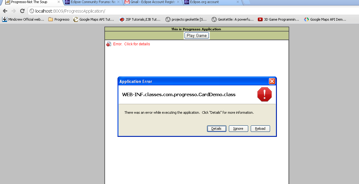

Applet not showing in browser [message #837248 is a reply to message #770554] Thu, 05 April 2012 08:46 Go to previous messageGo to next message
Hi have tried web application exactly like above problem,
Now I am really in trouble, Please help me ASAP.
I have created two class 1) Card.java and 2) cardDemo.java(It's Applet) in eclipse and create htmi page index.html in webcontent folder, now I am trying to run this applet in html form its gives a Application Error, I have also tried paste classes folder in WEB-INF and change path applet tag, but not working.

My applet is running from Run as->Java Applet
please -please help me what can i do.
please see the broblem in attachment file
I am running using tomcate URL is
  • Attachment: problem.bmp
    (Size: 2.00MB, Downloaded 331 times)
[Updated on: Thu, 05 April 2012 08:56] by Moderator
Re: Applet not showing in browser [message #840440 is a reply to message #837248] Tue, 10 April 2012 00:57 Go to previous message
NOTHING under WEB-INF is served to the browser (client). The classes folder there is meant to be used only for server-side code.
