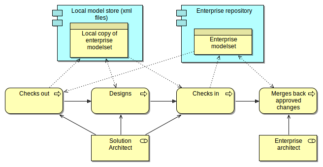

We are talking about Archi which is an architecture modeling tool. I would like to make possible the below scenario. I assume that the enterprise repository is one CDO repo. I want to minimize confusions arising from cases where there are cross references between instances of models, where the instances of models holding the referenced entity is not available. I don't want to constrain the user to be able to use one cdo repo at a time, but want to avoid making references between different repositories accidentally, so the enterprise repository will not reference anything outside itself (Except when the enterprise architect explicitly chooses to reference objects in another repository, e.g. because of division of governance domain. But it can be an advanced feature implemented much later.)
