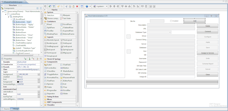

I tried your example code and it worked fine on my end. I moved several widgets around including the one you mentioned (see the pic below).
index.php/fa/6445/0/
What exact build of WB are you using?

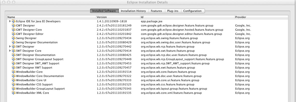

Re: WindowBuilder Design Mode changes parent when moving objects [message #764976 is a reply to message #764832] Tue, 13 December 2011 03:06 Go to previous messageGo to next message
Curious. Then it's maybe my environment which is the problem. I am working on a MacBook Pro running OSX Lion.
java version "1.6.0_29"
Java(TM) SE Runtime Environment (build 1.6.0_29-b11-402-11M3527)
Java HotSpot(TM) 64-Bit Server VM (build 20.4-b02-402, mixed mode)
Eclipse 3.7 SR1
(see attached screen dump for detailed versions)
